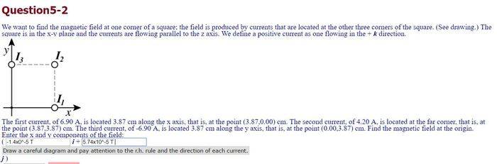

Find the magnetic field at the origin

okay so what i did was use the equation above and find the magnetic field (B) for I1 I3 and the x and y component of I2.Also, i used the right hand rule to determine the direction of the magnetic field for each one and I get :
I1 = 3.57x10^-5 T in the -y direction
I2 x-comp = 2,17x10^-5 T in the -y direction
I2 y-comp = 2.17x10^-5 T in the +x direction
I3 = 3.57x10^-5 in the -x direction
I tried subtracting -x direction value from the +x to find the x-component at the origin and i tried adding the 2 -y values to find the y-comonent of the magnetic field at the origin I get :
x-component : -1.4x10^-5 T
y-component : 5.74x10^-5 T
but that is said to be wrong , so please any help is appreciated
Check the values for the x and y components of the field due to I2.
i still get 2.17 x10 ^ -5 for both. the "r" in the x and y directions is the same which is 0.0387. and the current if I2 is 4.20A. so that's :
B= [4pi x 10^-7 * 4.20A]/[2pi*0.00387] = 2.17 x 10^-5 T for both of them
I don't see where i made a mistake
Did you use the correct value of r for I2? How did you calculate the x and y components of B2 from the magnitude of B2?
For I2 it appears that you might be trying to get Bx by doing something like Bx = μ0I2/ (2πy), where y is the y-component of r. But this is not correct.

Check over your work. From previous posts, you have indicated that you have the correct x and y components of the three B fields. So, you might be making a careless error in combining the components. Watch the signs. If the grader is picky about significant figures, then you might try keeping an extra significant figure in the calculations.
If you want me to try to spot a specific error, then you will need to show your work in detail.
I'm sorry that the image is flipped but i tried uploading the pic multiple times but it still not straight , and I'm down to my last try so please look carefully at my work cause otherwise I'm getting 0 on this questions and it counts for a lot.Thanks for your help.Btw i don't get why I had to find the vector for the magnetic field cause by I2 and then separate into x and y components instead of just find the x and y components immediatly since i already have the values for both the distance in x and in y
OK. Now I can see where there are mistakes.
How can the x-component of a vector be in the -y direction?
How can the y-component of a vector be in the +x direction?
The net ##\hat{i}## component is the sum of the individual x-components. Also, you need to check if you have the correct signs for the individual components.
In problems like this, you should include a sketch where you show the individual B fields drawn at the origin roughly to scale. You can then see from the sketch what the signs of the x and y components of each field will be. You will also be able to deduce from the diagram the signs of the net x and y components and also see roughly the relative magnitudes of the net x and y components.

This gives me -2.48x10^-5 T in the i direction and 2.48x10^-5 in the j direction does this look correct ?
I believe one of these is correct. Check your work and see if you can discover which is wrong. Did you draw a sketch? If so, you can see that the x and y components of the result will not have the same magnitude.
you're right it should be -2.48x10^-5 T in the i direction and -4.66x10^-5 in the j direction right?
