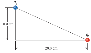

Two point charges are placed at two of the corners of a triangle as shown in the figure. (Take q1 = -11.3 μC, and q2 = 15.4 μC.) Find the magnitude and the direction of the electric field at the third corner of the triangle. {Correct Answer: 1.07e+07 N/C at 71.2 degrees above the -x-axis}
