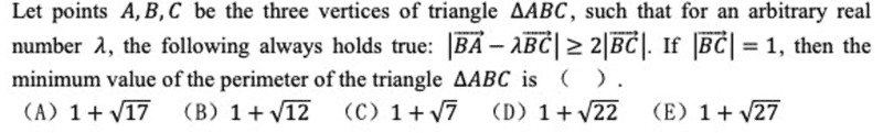

Find the minimum perimeter of a triangle with these constraints
4 replies · 3K views
songoku
2,521
395
Please see below
Not really sure
My attempt:
$$|\vec{BA} -\lambda \vec {BC}| \geq 2|\vec {BC}|$$
$$|\vec {BA}|^2 -2 \lambda (\vec {BA} \cdot \vec {BC}) +\lambda ^{2} |\vec {BC}|^2 \geq 4|\vec {BC}|^2$$
$$|\vec {BA}|^2 -2 \lambda |\vec {BA}| \cos \theta +\lambda ^{2} \geq 4$$
Am I even on the right track?
Thanks

$$\lambda^2-2 \lambda |\vec {BA}| \cos \theta+|\vec {BA}|^2 -4 \geq 0$$
Using D ≤ 0 :
$$4 |\vec {BA}|^2 \cos^2 \theta-4|\vec{BA}|^2+16 \leq0$$
$$-|\vec {BA}|^2 \sin^2 \theta +4\leq0$$
$$|\vec{BA}|^2 \sin^2 \theta \geq 4$$
The maximum value of ##\sin^2 \theta## is 1 so the minimum value of ##|\vec{BA}|^2## is 4 and the minimum value of ##|\vec{BA}|## is 2
By taking ##|\vec{BA}|=2## and ##\theta = \frac{\pi}{2}##, I got ##|AC|=\sqrt{5}## so the minimum perimeter is ##3+\sqrt{5}##
Where is my mistake? Thanks
Following your strategy, I get the same (wrong) result. I guess it is the cosine that leads to the mistake. ##\phi## isn't independent of ##A## so you cannot treat it as a constant.
How about the following strategy:
We may assume ##B=(0,0)## and ##C=(1,0)## and ##A=(x,y)## with ##y>0.##
Then the condition reads ##\sqrt{(x-\lambda )^2+y^2}\geq 2## which implies ##y\geq 2.##
The minimal perimeter is then ##1+\sqrt{x^2+y^2}+\sqrt{(x-1)^2+y^2}## which is obviously minimal for ##y=2.## Thus we have to minimize the function ##f(x)=\sqrt{x^2+4}+\sqrt{(x-1)^2+4}.##
