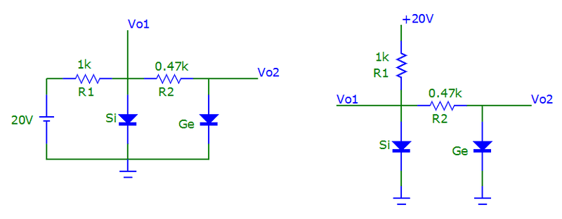

Find voltage at Vo1 and Vo2
The left part is the schematic used in the question. The right side is the engineering schematic I drew up.
I'm not sure what to do here.
because there is a Si and Ge diode that means the Ge will be actived first because the forward voltage is only 0.3V (vs 0.7V of the Si diode).
So how should I look at this circuit then?
ignore the Si diode and then Vo1 is the voltage across R2 and the Ge diode, and Vo2 is the voltage across only the Ge diode

Yes. Try assuming the Si diode isn't conducting (eg remove it). Check the voltage that would appear at Vo1. If it's >0.7 then the Si diode is conducting so put it back.
Ok so when ignoring the Si diode the voltage at Vo1 is 13.4V, >0.7V therefore it is conducting
so looking at the whole circuit. I could be completely confused, but because Si diode is parallel to R2+Ge diode, is the total voltage drop across R2&Ge diode only 0.7V?
edit: so Vo1=0.7V and Vo2=0.3V
seems too easy that's why i asked,,:)
The answer depends on the i-V characteristics of both diodes.
You seem to assume that the voltage across the Si diode is 0.7V irrespective of the finite current thru it, also 0.3V for the Ge. Under this assumtion, both diodes will be on regardless of the resistor values.
In reality, diodes like these have i ~ i0exp(V/26mV) with the Si i0 lower for the Si than for the Ge. Under this model, the outcome depends on the values of the resistors.
If you are given a different model, tell us ...
All the questions prior to this one assume the voltage drop across Si is 0.7V, and Ge is 0.3V.
But I do know about the V-I characteristics. However, I know about Shockley's equation: I=I0(exp(qVa/kT)-1), haven't seen i ~ i0exp(V/26mV) before.
In this case I guess I should write a range of simultaneous equations..
The voltage drop across the Si Diode will still be equal (and thus limit) the voltage across R2+Ge diode.. right?

The shockley equation & mine are essentially the same except at very low currents. You'll note that kT/q = 26 mV near room temperature.
Pick your i0 so that at the 1-10 mA level you get 0.3V for the Ge diode and 0.7V for the Si.
The thing for you to notice is that the current thru the 1K is very much larger than the current thru the 0.47K.

It's pretty clear that the current through the Si is high enough for 0.7V to be a reasonable approximation for Vo1.
Then you effectively have 0.7V feeding the Ge via a 470 Ohm...
First stab for the current through the Ge diode would be (0.7-0.4)/470 = 0.66mA which is just about enough for most Ge diodes to be considered "On" eg for 0.4V to be a reasonable approximation for Vo2.

EDIT: Actually looking at that chart 0.25-0.3V would be a more reasonable value for Vo2 based on that diode data.
