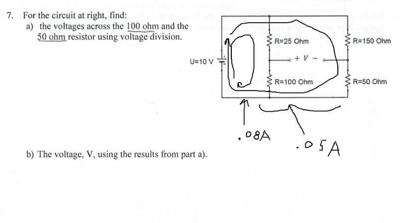

7a from picture
V=IR
Voltage division

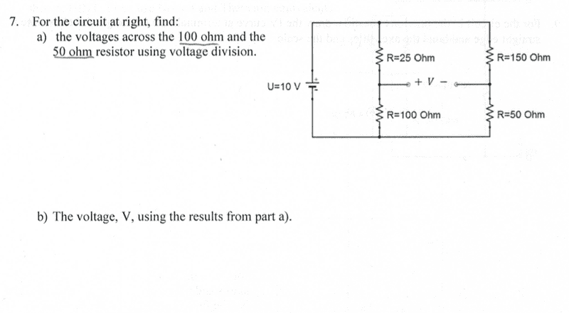

I am not sure how to apply voltage division here. It is a new concept for me and I'm not really sure how to apply it here. voltage division can only be used in series, but these resistors are not in series. I also am not sure how to deal with the 2 voltage sources. Is there a way to add them to make this simpler? What do I do with the 10V source exactly? I could find a current, but wouldn't it be only through the one loop on the left? I=V/R=.08A.
Assume the negative terminal of the battery at 0V. Can you find the current through the two branches?

Let's keep ground aside for a minute. You've found the current in one branch correctly. What will be the current through the other branch?
Ok, so I just ignore the V on the right for now? I thought that was like a wire and it would mess with the circuit. The current for the first loops is .08A and for the second loop it is .05 A.

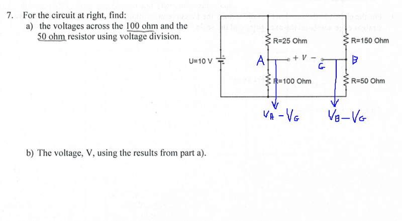

Label the points as A and B between which the voltage is asked(upper ends of 50ohm and 100 ohm). Label the negative terminal as G. You have VA-VG and VB-VG. Can you find VA-VB from this?

Label the points as A and B between which the voltage is asked(upper ends of 50ohm and 100 ohm). Label the negative terminal as G. You have VA-VGand VB-VG. Can you find VA-VB from this?
I am not really following what you are doing here. Do I find the voltage at point by using equivalent resistances and then the same at point B and then subtract? So at point A the voltage is V=IReq= (.08A)(125ohms). and then do the same at point B?

No. If you labelled correctly, + is A, - is B and negative terminal of battery(where lower ends of 100Ω and 50Ω meet)is G.
You got voltage across 100Ω as 8V. Isn't it VA-VG?

I'm still not following where you are getting these equations or how they are related. Is there a different approach? Or can you explain you approach more?

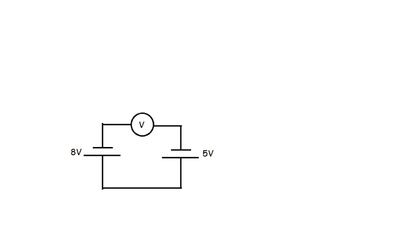

Can you say what this voltmeter would read?
Marcin H said:
Ok. I got 8V for the 100ohm and 2.5V for the 50ohm using ohms law.

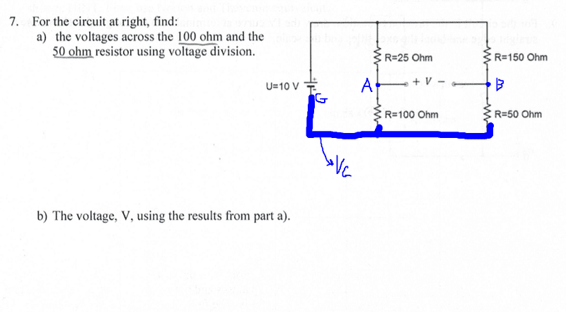

This means voltage "across" 100Ω is 8V and that "across" 50Ω is 2.5V. In the diagram, + is A and - is B(you have labelled them correctly). Do you see the negative terminal of the 10V source is connected to bottom ends of 100Ω and 50Ω using a wire? That wire is point G. Are you aware of the fact that all the points on a wire are equipotential? That means, the common ends of 100 ohm and 50 ohm are at same potential, i.e. VG.
Merlin3189 said:
Can you say what this voltmeter would read?View attachment 95081
3V
Ok. So like this? What are Va and Vb then?

You have the value of Va-VG and VB-VG. What will be VA-VB then?
Va-Vg=8V and Vb-Vg=2.5V? Using those equations, solve for Va-Vb and get 5.5V?
Exactly! If you assume VG=0, you'll get absolute values of Va and Vb as 8V and 2.5V. The difference is 5.5V.
