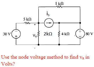

Find Vx using node voltage method

Samira
is= 1.2 mA
i submitted my solution but it was wrong,can someone please explain why?

I haven't gone through all your working but check the polarity of the 30V source and the first term in the KCL equation.

I still think the first term should be (Vx - (-30)) / 5
For example to be consistent with the third term (Vx-(+80))/1
Argh! You're right! I missed the reversed polarity on the 30 V supply o:) Good catch.
@Samira : The first term in your node equation needs to be fixed. It should be ##\frac{V_x + 30}{5}## .
