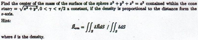

Problem (also attached as TheProblem.jpg):
Find the center of mass of the surface of the sphere x^2 + y^2 + z^2 = a^2 contained within the cone z tanγ = sqrt(x^2 + y^2), 0 < γ < π/2 a constant, if the density is proportional to the distance from the z axis.
Hint: R_cm = ∫∫_S δR dS / ∫∫_S δ dS, where δ is the density.

The first thing I'm stuck on is knowing what δ and dS are. How do I determine what those are (without “cheating” and looking at the solution)?

That isn't a relevant equation. Surface integrals are double integrals, not triple integrals. The radius of the sphere given as ##a##.
Surely your text gives ##dS## for spherical coordinates. As for ##\delta##, what is the point on the ##z## axis nearest to ##(x,y,z)##? What is the distance from that point to ##(x,y,z)##? You could answer that in rectangular coordinates and change it to spherical, or write it directly from the figure in spherical coordinates as the solution does.
