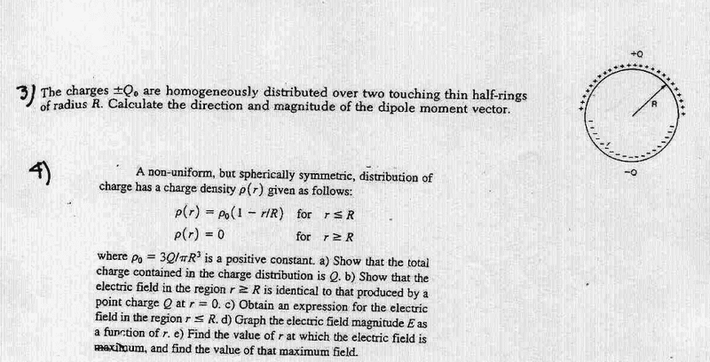

Problem 3 from the attached photo
p = qd
I know the magnitude of the dipole moment is p = qd, where d is the distance between the 2 oppositely charged particles. I know the direction of the dipole moment vector is from - to +. My first thought is there's no charge separation, and hence a dipole moment equals zero. Something tells me this isn't the case.
I don't know why you think there is no charge separation. Some charges are R√2 from the nearest opposite charge. Only where the two semicircles meet is there no separation.

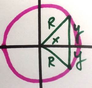

What if I setup like this (attached), using:
p = ∫dp = q∫2y = 2q∫(R2-x2)0.5dx from R to -R? Don't I need to differentialize Q somehow?
That integral should work, but you will find it easier in polar coordinates. I don't know what you mean by "differentialize Q".

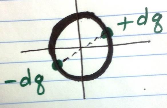

So, using...
...would we use d = charge separation = 2R, not d=R?
So, p = ∫dp = ∫d(dq) = ∫(2R)dq = ∫(2R)[λRdθ]
Where λ=Q/s, so Q = λs, or dq=λds=λRdθ, resulting in...
So, p = 2λR2∫dθ from pi to -pi?
This isn't feeling right since nothing is mentioned about charge density...??
So, using...
No, the integral you have now won't work. The dipole moment is a vector. Integration is a sum, so when you integrate vectors you need that sum to reflect vector addition. Your diagram above pairs charges in such a way that the dipoles willpoint in different directions.
Your previous way of pairing them was fine, and so was the integral you wrote down. You just need to rewrite that integral in polar form.
