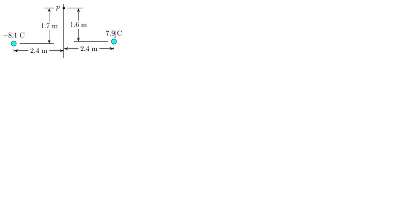

Two charges are located in the (x, y) plane as
shown. The fields produced by these charges
are observed at a point p with coordinates
(0, 0). Find the x-component of the electric field
at p. The value of the Coulomb constant is
8.98755 × 109 N · m[itex]^{2}[/itex]/C[itex]^{2}[/itex].
Answer in units of N/C
k[itex]_{c}[/itex] = 8.98755E9
cos θ[itex]_{12}[/itex] = [itex]\frac{1.7}{sqrt(8.65)}[/itex]
cos θ[itex]_{13}[/itex] = [itex]\frac{1.6}{sqrt(8.32)}[/itex]
q[itex]_{2}[/itex] = -8.1 C
q[itex]_{3}[/itex] = 7.9 C
r[itex]_{12}[/itex] = [itex]sqrt(8.65)[/itex]
r[itex]_{13}[/itex] = [itex]sqrt(8.32)[/itex]
E[itex]_{x}[/itex] = -(k[itex]_{c}[/itex]|q[itex]_{2}[/itex]|cos θ[itex]_{12})/r_{12}^{2}[/itex] - (k[itex]_{c}[/itex]|q[itex]_{3}[/itex]|cos θ[itex]_{13}[/itex])/r[itex]_{13}[/itex][itex]^{2}[/itex]
= -k[itex]_{c}[/itex]([itex]\frac{8.1}{8.65}[/itex] * [itex]\frac{1.7}{sqrt(8.65)}[/itex] + [itex]\frac{7.9}{8.32}[/itex] * [itex]\frac{1.6}{sqrt(8.32)}[/itex])
is this the right way to do it?

Hard to say since you didn't show or describe the locations of the charges ...
sorry here is the picture

Not quite alright.
Where are the angles, θ12 , θ13 ?
