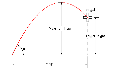

How to find the initial velocity required for a projectile to be launched at an angle theta, with a distance 'd' and height 'h'.
An expression is required. I am unable to find one using all three.

Let's see if I understand. The target is d meters away, horizontally, and is h meters higher in elevation than the launch position. You want to know what velocity, v, is needed to launch the projectile at an angle of θ and have the projectile hit the target. Is that correct?
Yes that is correct. Given height, distance and angle of launch, find velocity.
PS: That is an awesome drawing!
I'd start off by writing Newtons law for the projectile
F=ma
since the force is gravity we have F=mg and so for the y axis
a=g
you can either solve this differential equation or look up the solution, it should be in any intro physics textbook, and you'll find that the y position of the particle is;
y=a_0+a_1t+\frac{g}{2} t^2
and for the x position you'll find;
x=b_0+b_1t
you'd then set a_0 = b_0 = 0 to make the projectile be launched from the origin of co-ordinates
you set the velocity as V Sin and V Cos, which gives you;
y=V Cos( \theta ) t + \frac{g}{2} t^2
x=V Sin( \theta )t
so you now have to equations which you can solve, given some time you want to hit the target at, for V and theta
Tan( \theta )=\frac{x}{y-\frac{g}{2}t^2}
\theta = arctan(\frac{x}{y-\frac{g}{2}t^2})
where x and y are the x and y of the target
and you can substitute your theta back into find the V
if you already had the angle theta (I couldn't tell from your OP) you can put it in the tan equation and solve for t, then sub that into the x equation to get v
good luck!
I have the angle theta, the distance the target is away and the height of the target. I don't have the time.
I need to find the initial velocity of the projectile.
From your equations,
I get the "v sin" and "v cos" equations for x and y.
Shouldn't the 'x' eqn use v cos(theta) and 'y' be v sin(theta)?
But where do I get the value of 't'?
Also, the tan(theta) doesn't give me the velocity?

Write the equations for the horizontal and vertical components of the motion. Use v cos(θ) for the initial horizontal velocity, and v sin(θ) for the initial vertical velocity. When the projectile is at the target, how will these equations look (what values are in place for the x and y variables)?
OK this is my equation for 't',
t=\sqrt{}((xtan\vartheta - y)/(-0.5g))
Can I substitute this for 't' in the equation,
v = x/(cos\varthetat)

All I did is switch it to ,
y=V Sin( \theta ) t + \frac{g}{2} t^2
x=V Cos( \theta )t
and then divided y/x to get tanθ and hence the equation.
Okay, well this is really going the long way around!
y = v\;sin(\theta)\;t + \frac{1}{2} g t^2 (for some reason choosing a negative value for the constant g :confused:)
x = v\;cos(\theta)\;t
Then:
sin(\theta) = \frac{y - \frac{1}{2} g t^2}{v t} and
cos(\theta) = \frac{x}{v t}
tan(\theta) = \frac{y - \frac{1}{2} g t^2}{x}
Solving for t:
t = \sqrt{\frac{2}{g} (y - x\;tan(\theta)}
The reason I say that this is the long way around is that you can find a value for t very easily from the equation for the horizontal motion. Substitute that into the equation for the vertical motion and solve for v.
Now, I'm confused. Let me explain the whole scenario.
I have to make a spring launcher that will fire a stretched spring. I will be given a target that is 'x' meters away and 'y' meters high w.r.t launch point. I will also be given an angle of launch theta.
My solution (as of now),
x = v cos θ .t -----------------------------------------------------------------Eqn 1
y = v sin θ + 0.5gt2 (where g is -9.8, I will keep that in mind!)
We get the equation,
tan θ = (y-0.5gt2)/x
Solving for t,
t = √((x tanθ - y)/ (-0.5g)) (again g is -ve)
Now from eqn 1,
v = x / (cos θ.t)
Substituting for t,
v = (x) / [ cosθ . √((x tanθ - y)/(-0.5g)) ]
Now to find the stretch x,
k -> Spring constant, z-> stretch
Elastic Energy in spring = Kinetic energy
0.5kz2 = 0.5mv2
z = √([mv2 ] / k)
Substituting for v,
z = √[ (m/k)( (x2) / (cos2θ ((x tanθ - y)/(-0.5g)) ) ]
That was my grand equation. Let me know what you think.
