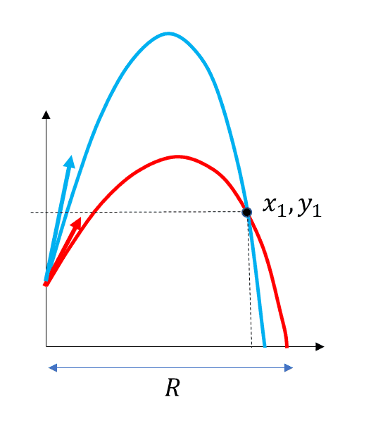

PeroK said:
Three points determine a parabola. You need some flexibility in the points to have a minimisation problem.
To me it seems like the solution would necessarily have to be a minimum though?
Diagram of two projectile trajectories from the same launch point: a lower red arc and a higher, longer blue arc, both passing through the labelled point x1, y1, with arrows showing launch directions and a horizontal range R marked below.
If ##R## is the maximum possible range the trajectory can have while passing through point ##(x_1,y_1)## ( the red trajectory), then if we desired to shorten the range to the blue curve while maintaining ##( x_1,y_1)##, we would have to increase the velocity ( and angle ) to do so (the blue trajectory)?
So what I'm saying is scratch the minimization problem in post #3, its not going to work.
This can't be true in general. Although, it's not clear precisely what assumptions you are making.

Yeah, but if the total range is reduced, and the parabola must still pass through ##(x_1,y_1)##, then the initial velocity and angle must be increased as far as I can tell. This is what I was trying to get at with post #8.
There is no such maximum. Send it at light speed through that point.
You might instead have defined the red trajectory as the path of minimum launch speed that goes through the target point, but you cannot assume its landing point is beyond the baseline.
No, ##R## is the maximum range for which the ball passes the obstacle ##(x_1,y_1)## and lands in bounds. They are talking about a tennis lob.

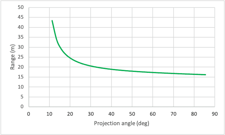

Since optimization is not the issue and you want to know the possible ranges with the projectile just clearing point ##(x_1,y_1)##, then equation (4) in the article I quoted in post #11 is the way to go. It is the trajectory equation transformed to include the tangent of the projection angle ##\theta## and the tangent of the angle ##\varphi## that the instantaneous position vector makes relative to the horizontal. It is extremely useful, especially with problems like this one. $$\frac{\Delta x}{\tan\!\theta-\tan\!\varphi}=\frac{2v_{0x}^2}{g}.\tag{1}$$ Note that the right-hand side is a constant of the motion which means that the left-hand side is also a constant of the motion. This eliminates the need for ##v_0## because we can write $$\frac{\Delta x_1}{\tan\!\theta-\tan\!\varphi_1}=\frac{\Delta x_2}{\tan\!\theta-\tan\!\varphi_2}$$Using names of variables as you defined them, we have
##\Delta x_1=x_0##, ##~\Delta x_2=R##; ##~\tan\!\varphi_1=\dfrac{y_1-y_0}{x_0}##; ##~\tan\!\varphi_2=\dfrac{-y_0}{R}##. If one puts them in the equation above, one gets a quadratic in ##R## with ##\tan\!\theta## the independent variable. It can be solved to yield the range as a function of projection angle given the constraint that the projectile passes through point ##(x_1,y_1)##. The solution produces pairs of projection angles and ranges. The initial speed is strictly determined, given a choice of the projection angle, using equation (1).
I generated two plots using parameters other than OP's (for obvious reasons). I chose ##x_0=16~## m; ##~y_0=2~##m;##~y_1=4~##m and generated a first plot giving the range as a function of projection angle. At each projection angle there is only one value of the initial speed such that the object passes through ##(x_1,y_1)=(16,4)~##m. If ##R## is known, then there is only one value for the projection angle and, through equation (1) above, only one value for ##v_0.## This first plot is shown below.
Line graph of range (m) against projection angle (deg): a green curve falls steeply from about 43 m at 11 degrees to about 16 m at 85 degrees, flattening out at larger angles.

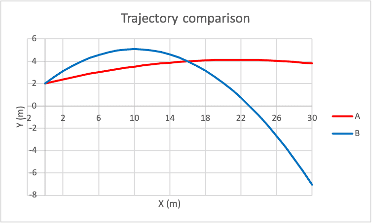

Then I plotted two trajectories by choosing angles and corresponding speeds. I chose
Plot A (red): ##\theta = 11^o##; ##~v_0=33.2~##m/s
Plot B (blue): ##\theta = 32^o##; ##~v_0=12.7~##m/s
The trajectories intersect at ##(16,4)~##m as expected and are shown in the second plot below.
Line graph titled Trajectory comparison, plotting Y (m) against X (m) for two curves, A in red and B in blue, both starting at (0, 2); A rises gently and levels off near 4, while B peaks near 5 at x of about 10 and falls below zero past x of about 23.
