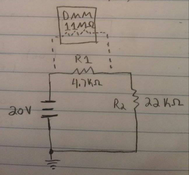

Here is my sketch, but am unsure it this is what you were suggesting.
  • Handwritten circuit sketch: a 20 V battery in series with R1 (4.7 kΩ) and R2 (22 kΩ), with a DMM (11 MΩ) drawn in dashed lines connected across R1.
Josh225 said:
Im not 100% sure by what you mean by making a sketch. I thought 26.7 kilohms would be the total resistance within the circuit (by adding the 2 resistors together). If not, how would you do so?
Part (b) of the question asks you to measure V2 assuming an internal impedance of 11M in the meter. Your sketch shows the meter across the wrong resistor.
I would suggest you calculate the current in the circuit in the usual way, then calculate the voltage (theoretically) across R2. Once you have done that, measuring the voltage with the meter effectively places two resistors in parallel. So what do you think would happen to the circuit current if you change the effective resistance of R2? And if the current is different, what would happen to the voltage drop across R2, would it be the same as you calculated in part (a)?
Yes your sketch is exactly what I meant but as Numbskull said you have the meter across the wrong resistor.
