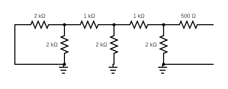

How would we calculate the Thevenin's resistance for the above circuit? The right answer for this circuit is 1.5 kOhm.
$$R_{567} = R_7 + (R_5 \parallel R_6) = .5 + .67 = 1.2 k\Omega$$
$$R_{34567} = R_3 + (R_4 \parallel R_{567}) = 1 + .75 = 1.75 k\Omega$$
$$R_{TH} = R_1 + (R_2 \parallel R_{34567}) = 2 + .93 = 2.93 k\Omega,$$
which is not the right answer. Where am I making the mistake?
R5 and R6 are not in parallel.
Hint: start at the other end...

(1) Which sub-forum should I rather post it in?
(2) Starting at the other end:
$$R_{123} = R_1 + (R_2 \parallel R_3) = 2 + \frac{2}{3} = \frac{8}{3}\ \text{kOhm}$$
$$R_{12345} = R_{123} + (R_4 \parallel R_5) = \frac{8}{3} + \frac{2}{3} = \frac{10}{3}\ \text{kOhm}$$
$$R_{TH} = R_{12345} + (R_6 \parallel R_7) = \frac{10}{3} + \frac{2}{5} = \frac{56}{15}\ \text{kOhm} \neq 1.5\ \text{kOhm}$$
Still not the right answer.

In this case I believe the "key" is to realize that all the nodes at the bottom (which connects R2,R4 and R6) are grounded and at the same potential
It is therefore perfectly fine to re-draw the circuit and replace the sole ground symbol a the bottom left corner with individual ground connections for each resistor (R2, R4 and R6), once you've done this you can "cut" the leads between R2 and R4, R4 and R6 without changing the circuit in any way.
Try this. It should make it easier to see which resistors are in parallel.
Also,don't try to do too much as once. "Replace" two resistor at a time with a new resistor. Start in the left hand corner.

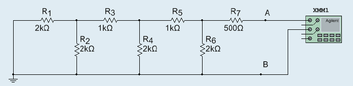

It looks like R1 and R2 are in parallel, and R12 is in series with R3. And R4 and R5 are in parallel and R3 is in series with R45. Then R6 and R7 are in parallel. Is that right?
You are on the right track.
You do not need ground unless you are computing currents and voltages.
Slide the ground symbol along to point B.
Recognise the pattern. The circuit you have is called an R:2R ladder.
Notice that...
If two identical value resistors are in parallel, the equivalent is half the value of one resistor.
If two resistors are in series, the equivalent is the sum of the two.
Start with R1//R2.
You should be able to progressively reduce the circuit to the thevenin equivalent, from left to right, without writing an equation.
Yes, that is what I meant.
I should point out that my description above wasn't very good :frown: . Current CAN of course flow to ground in the lower lead (meaning current is strictly speaking flowing between the bottom nodes, although they are at the same potential).
I was trying to explain why re-drawing the circuit the way you did is fine, but I should have been more careful in my wording
Baluncore's suggestion of simply "sliding" the ground symbol to B would have been a better suggestion.
$$R_{12} = R_1 \parallel R_2 = 1$$
$$R_{123} = R_{12} + R_3 = 2$$
$$R_{1234} = R_{123} \parallel R_4 = 1$$
$$R_{12345} = R_{1234} + R_5 = 2$$
$$R_{123456} = R_{12345} \parallel R_6 = 1$$
$$R_{\text{TH}} = R_{123456} + R_7 = 1.5$$

It is not some additional component in a circuit. Ground is just a node which is "assigned" a potential of 0V. All other node voltages are w.r.t the ground node. You can choose any node as the ground node, just be consistent with directions and polarities.
