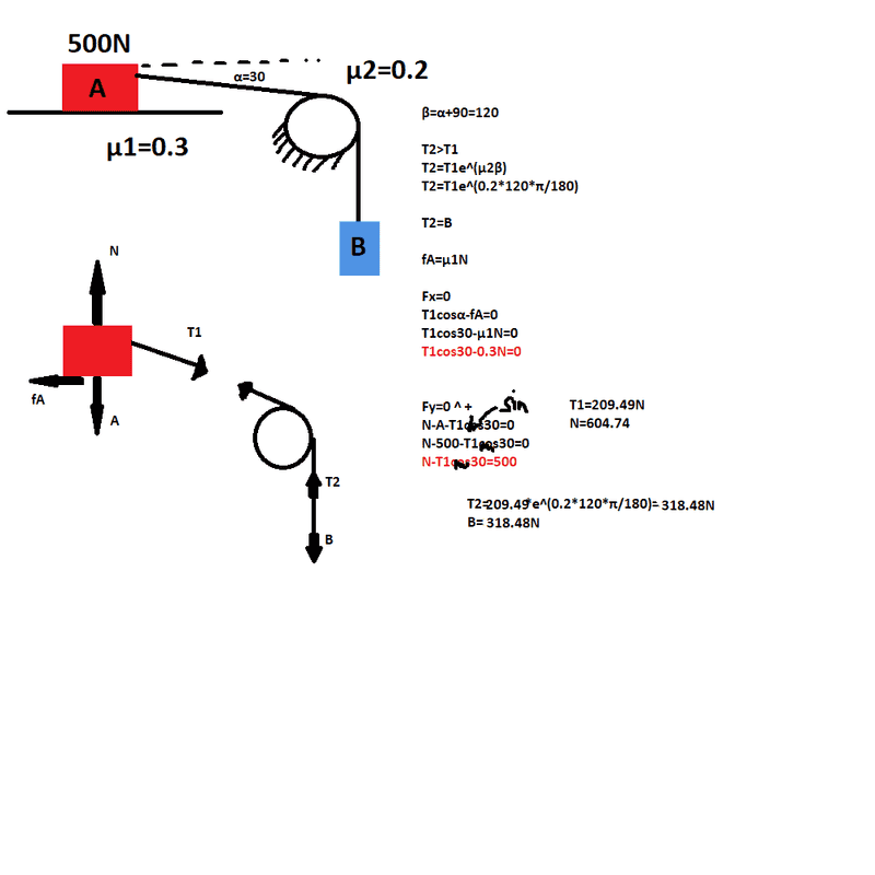

Given the weight of block A, friction coefficients and an angle determine the max.weight of B for which the system will stay in balanc
fg=µ1N
T2=T1e^(µ2β)
You have ##\beta=\alpha+90^o##. Check that.
So it should be -90? I don really understand how I have to determine the angle

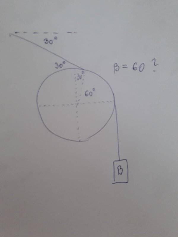

Did you draw a diagram of the circle with radii to the ends of where the string arcs over it?
no, but it does seem like the rope arcs over a 90 degree area
If the upper section of the string were horizontal it would be 90 degrees. But it isn't.
Mark the ends of string contact on that circle.
Okay so
cos30T1=0.3*500
T1=173.205
B=173.205*e^(0.2*300* π/180)=493.574N

Did you draw the diagram I described?

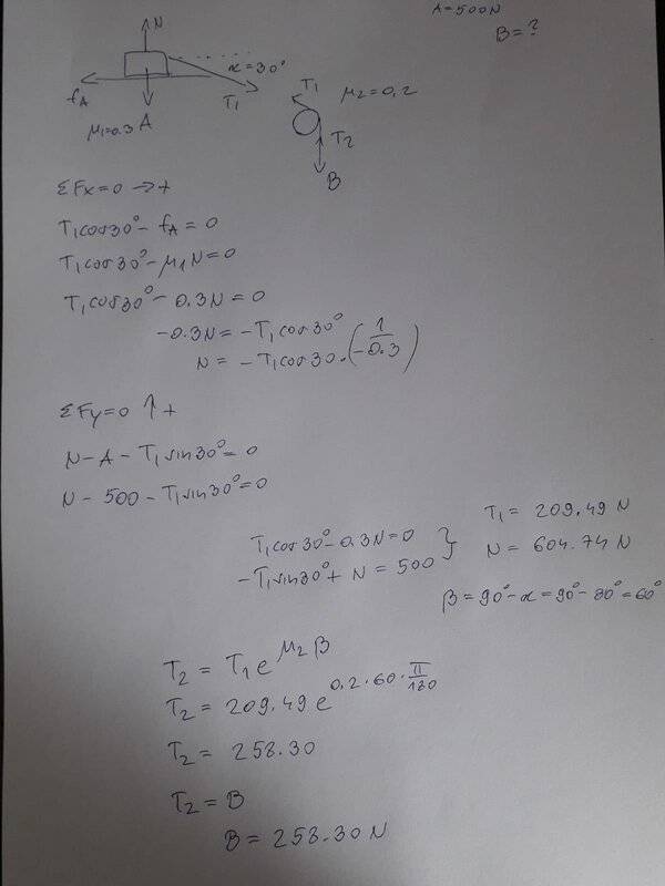

then beta should be 60 right?

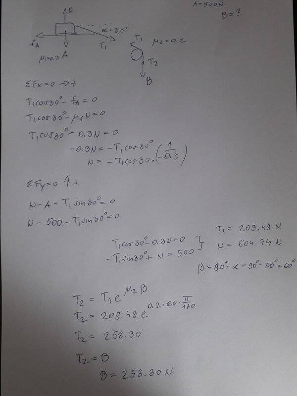

Great then this should be correct

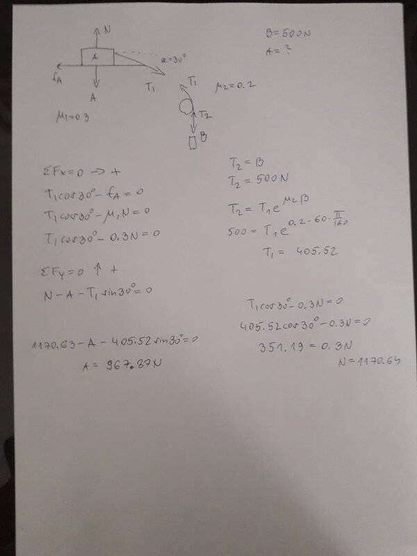

Thank you now I have one more question, what if almost everything was the same but... I was given weight of B and needed to find A, would I be able to use T2=T1e^(µ2β)
To find the minimum A for equilibrium? Sure - why should the equations change?
