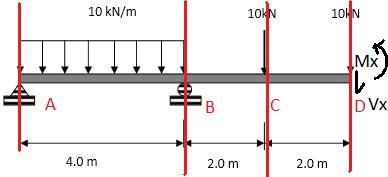

Studious_stud
38
I am attempting to calculate the shear force Vx, and bending moment Mx within the interval C - D of this beam.
ƩFy = 0
ƩMx = 0
I have calculated the support reactions to be RA = 5kN and RB = 55kN
ƩFy = 0
5 + 55 - 10(x-4) - 10 - Vx = 0
ƩMx = 0
5x + 55(x-4) - 10(x-2) - 10((x-4)^2/2) - Mx = 0
I'm really not sure if this is correct or not! Any help would be greatly appreciated :)
Thanks all
These are not correct, it is easier to draw free body diagrams which cut through CD about the RIGHT end of the beam. The shear will jump right out at you. And for the moment in between C-D, use D as the origin of your x value, right to left for x.
