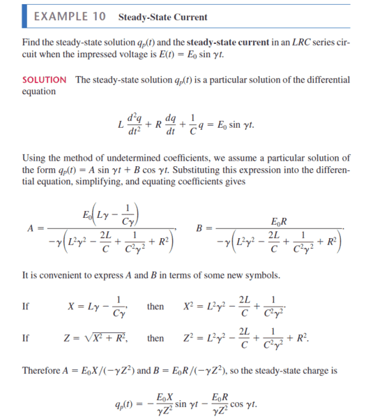

I want to get the particular solution for:
Lq''+Rq'+(1/c)q = Esin(xt)
I got the particular solution and its derivatives:
q = A*Sin(xt) + B*cos(xt)
q' = x*A*cos(xt) - x*B*sin(xt)
q'' = -x^2*A*sin(xt) - x^2*B*cos(xt)
I plug these into the 2nd order equation giving me:
A[-x^2*L*sin(xt) + R*x*cos(xt) + (1/c)*Sin(xt)] + B[-x^2*L*cos(xt)-x*R*sin(xt)+(1/c)*cos(xt)] = Esin(xt)
I want to get the form of A and B in the attached image
Also, alpha = x in my typing.
  • Worked example from a textbook: steady-state charge of an LRC circuit with impressed voltage E0 sin γt, showing formulas for coefficients A and B in terms of L, R, C and γ, and the resulting particular solution qp(t).
Identifythe factors of sin(xt) on both sides of the wquation and then do the same for cos(xt). That gives you two equations for two unknowns.
I'm not sure if I understand. So I factor out sin(xt) on both sides and factoring cos(xt) giving me:
sin(xt)*[-L*x^2*A - R*x*B + (1/c)*A] + cos(xt)*[-L*x^2*B + R*x*A + (1/c)*B]
That's just one side of the equation. You need to do it on both sides and then identify the factors on either side.
But the other side is just Esin(xt).
So I have:
(-L*x^2*B) + (R*x*A)+([1/c]*B) = 0
(-L*x^2*A) - (R*x*B) + ([1/c]*A) = E
Orodruin said:
Right. Solve for A and B.
I got the answer, thank you.
