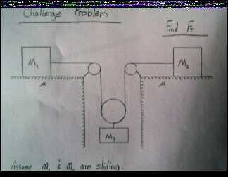

See Picture, The problem gives three boxes(M1, M2, and M3) and a few pulleys, no value for the coefficient of friction is given. None of the masses are known, and we are told to assume M1 and M3 are sliding. The objective is to find Ft
Hand-drawn physics diagram titled Challenge Problem with 'Find Ft' at top right: blocks M1 and M2 on horizontal surfaces connected by ropes over pulleys to a hanging block M3, with friction marked on the surfaces. Note below reads: Assume M1 & M3 are sliding.

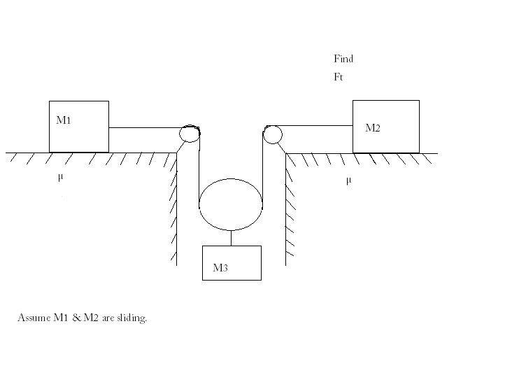

(if you can't see that well enough i made this)
Diagram of three masses connected by ropes over pulleys: M1 and M2 rest on a rough surface with coefficient µ, and hanging mass M3 is suspended below the centre pulley between two walls.
F=ma
Ff=µma
First I started of by drawing free body diagrams for all of the boxes, Using these(and assuming M1 and M2 are sliding towards the middle) I came up with
M1:
FNET=Ft-Ff
M1a=Ft-µM1a
Ft=M1a+µM1a
M2 Would then have the same equations except M1 would be M2 because it also has
FNET=Ft-Ff
(I feel like that might be wrong but I'm not sure)
I'm not sure about the signs on all of those either.
Then I have for M3
FNET=Fg-Ft
At this point I'm not sure what to do, (the lack of values is killing me) I would think putting Ft from the M1 equation into the Ft equation would be a good start, but then everything except mass would cancel wouldn't it? So that doesn't seem right. I feel like I'm going in the right direction and I need to use these equations simultaneously some how but I'm not sure what to do for the next step as I don't see how this is going to get me Ft.
Also I'm starting to think M2 Net force is different
FNET=Ff-Ft (Since the ropes would be moving in opposite directions) and that would also change the equation for M2 to
M2a=µM2a-Ft
Ft=µM2a+M2a
But even if that's right, what would i do with it...?
Any help is appreciated, I'm currently stumped. :confused:

OK, but be careful to distinguish the accelerations of each mass--they aren't the same. Call this acceleration a1.
FNET=Ft-Ff
OK. Use a2.
Then I have for M3
FNET=Fg-Ft
Consider M3 and the pulley as a single object and apply Newton's 2nd law as before. (Careful with the tension force here.)
Key point: How does the acceleration of M3 relate to a1 and a2? Figure that out.
Hint: Set up these equations correctly and you'll have 3 equations and 3 unknowns. (Treat the masses and μ as knowns.)
(You're on the right track.)

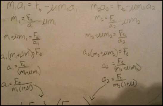

Handwritten derivation on paper: left column solves m1a1 = Ft - umha1 for a1 to get a1 = Ft/(m1(1+u)); right column does the same for m2a2 = Ft - um2a2, giving a2 = Ft/(m2(1+u)).

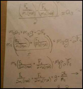

Handwritten derivation on lined paper: a fraction (Ft/(m1(1+u)) + Ft/(m2(1+u)))/2 = a3, then m3a3 = m3g - 2Ft, then m3 times that fraction = m3g - 2Ft, then Ft/(2m1(1+u)) + Ft/(2m2(1+u)) = g - 2Ft/m3.
Can you see anything I'm doing wrong?from this point i would get the Ft on the left and factor/solve
Edit:: Wow I feel stupid it does work out to gm/3... For some reason i thought 4+1+1 was equal to 5 >.<. I'm working it out again

Okay, i went back through it and, somehow i turned a positive into a negative in the middle of all my algebra for no reason. So now i have the same thing except
Ft=2gm1m2m3(1+u)/(m2m3+m1m3+4m1m2(1+u))
That's almost what I get. How did you get the (1+μ) in the denominator?

The friction force terms should be μMg, not μMa.
