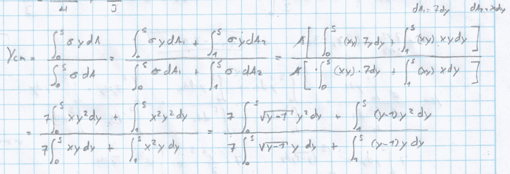

But as you can see in here, I ended up with square roots on the left:

Consider finding the mass of some shape. The general form is ∫σ.dA. In Cartesian, that's ∫σ.dxdy.
In the present problem, σ=Axy, so ∫∫Axy.dxdy. For the rectangle (x<0) the bounds are easy: ∫x=-7x=0y=0y=5Axy.dxdy.
See if you can solve that and do the right hand portion and the numerator integrals the same way.

I'm new to the doble integral notation, but I think that it would be ##\int_{0}^2\int_{1}^5 Axy\cdot dydx##.

No, that would be a rectangle. You need to relate the bounds on the inner integral to the value of the dummy variable in the outer integral.
E.g. suppose we integrate wrt y first. That means for the purpose of that integral x is a constant. What is the range of y in terms of that x?

Look at the top right diagram in your post #1. You show a vertical band width dx and a horizontal band height dy in the rectangle and another pair in the x>0 portion.
Consider the vertical band in the x>0 area. What is the range of values of y in that band?

The range of the y values are from 5-y to 5.

No, the range of y can't depend on y. It depends on x.

No, you are looking for a range of y as a function of x.
Look at your diagram. For that shaded vertical band, what is the value of y at the top? What is it at the bottom?

For y at the top the value is 7, and for y at the bottom it is 7-y. Right?

If y equals 7-y then y=3.5. We don't want y as a function of itself, that's not helpful. We want y as a function of x.
The bottom of the shaded strip lies on the curve y=x2+1. If the X coordinate is x, what is its Y coordinate in terms of x?

Y in terms of x would be function, right? ##y=x^2+1##?

Right, so that is your lower bound for y in that strip. The y integral is ##\int_{y=x^2+1}^5Axy.dy##.

For part A it was not necessary to do a double integral because the density was constant. You could just write down that the mass of the vertical strip on the right was σ(5-(x2+1))dx. That was instead of the integral (∫y=x2+1y=5σ.dy).dx

Your part A is ok.

You need to use double integrals everywhere in part B.
By always doing the y integral first you may avoid the square roots.

You have a double integral in y and x. You can do either first.
If you do x first it will have a bound that depends on y and involves a square root, so the result of the integral may involve a square root, which then becomes part of the integrand for the second integral.
If you do the y integral first it has bounds that involve x but no square root. The result will be a function of x, which you then need to integrate, but it will not have a square root in the integrand.
If you are feeling energetic you can try it both ways and compare.
