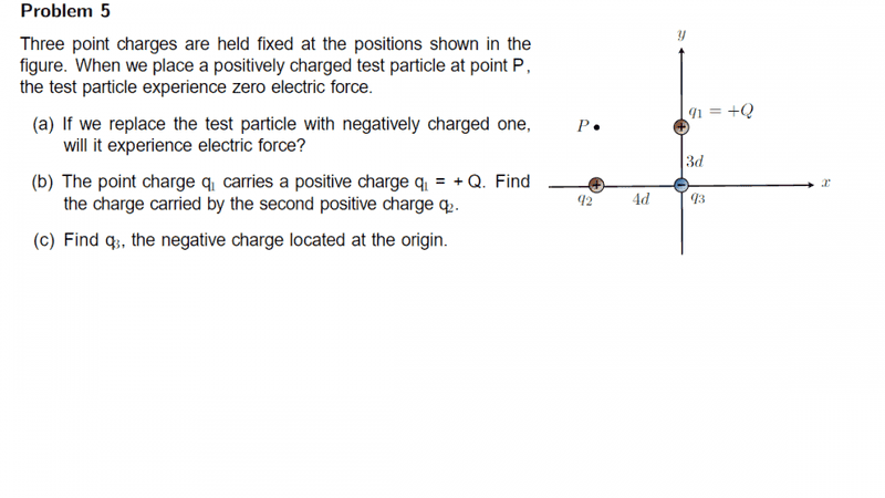

The problem should be attached, not sure how to do part b.
E=kQ/r^2
F=kQ1Q2/r^2
Enet=E1+E2+E3
I figured out a, but have no idea how to do b. I was thinking of summing up the electric field vectors at point p, but there are 3 variables for Enet.
If you sum the field vectors, how many scalar equations will you have? How many scalar unknowns are there? List them.
Something like this?
E1+E2+E3 = 0
kQ/16d^2 + kq2/9d^2 + kq3/25d^2(cos theta - sin theta) = 0
Not sure what to do from here though..
