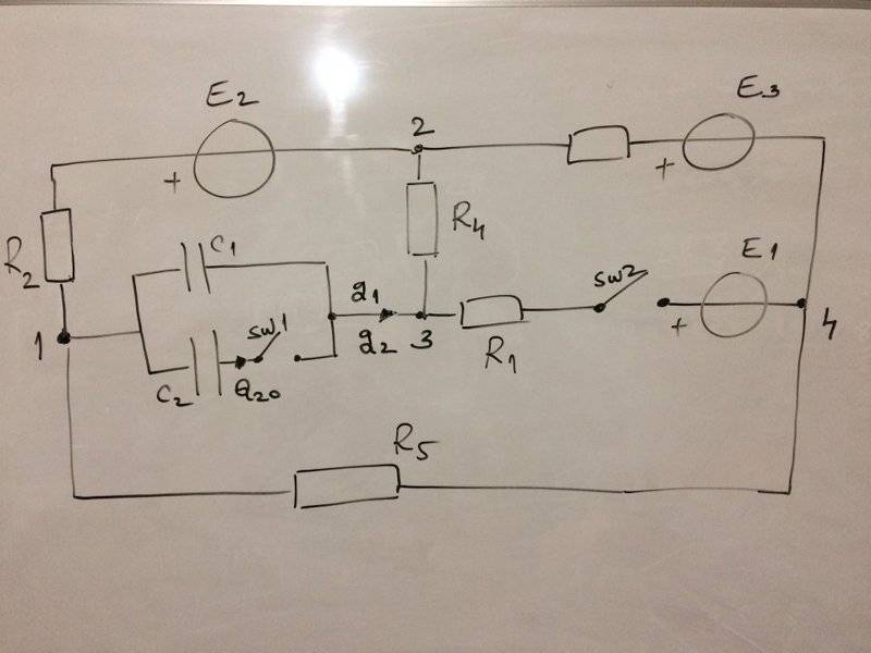

Finding the charge on a capacitor
4 replies · 3K views · last reply
diredragon
321
Hand-drawn circuit schematic with nodes 1 to 4, sources E1, E2, E3, resistors R1, R2, R4, R5, capacitors C1 and C2 with switches sw1 and sw2, and charge labels q1, q2, Q20.
[/B]
##E_1=6V##
##E_3=5V##
##R_1=150Ω##
##R_2=R_3=100Ω##
##R_4=50Ω##
##R_5=300Ω##
##C_1=1.5 mF##
##C_2=0.5mF##
Text:
In the first condition when the switches 1 and 2 are open the capacitor 2 has charge on it. First the switch 1 closes and the charge flow of ##q_1=1 mC## is established to flow through the branch as shown in the picture. Then the switch 2 closes and the flow is now ##q_2=-1.4mC##. Find the initial charge on capacitor 2 (##Q_{20}##).

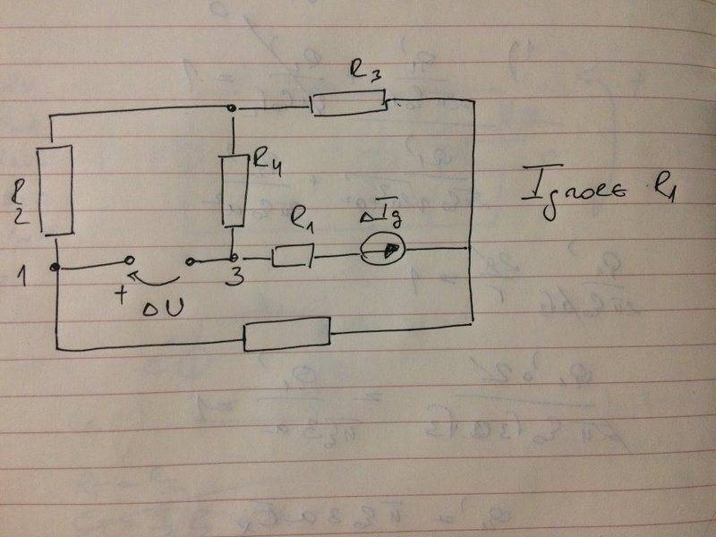

And ##q_{12}+q_{21}=q_2## and from there i can find the ##q_{12}## and ##q_{22}## and have the change in the voltage while my Δ-circuit looks like this:
Hand-drawn circuit schematic with nodes 1 and 3, resistors labelled R1 to R4, a voltage source marked ΔU with its switch, a current source marked ΔI_g, and the note 'Ignore R1' at right.
Where finding the current is trivial. Is this the right track?
Thanks
I continued along this road and i got a wrong answer. I will now post my full work so you can see where I'm wrong.
Strarting from the delta circuit where I am trying to find the current ##ΔI_g## i have this:
1) ##ΔU=\frac{q21}{C1}=\frac{q22}{C2}##
2) ##q21+q22=q2=-1.4##
##q21=\frac{C1}{C2}q22##
and from this i get ##q21=-0.35##,##q22=-1.05##
so ##ΔU=-0.7 V## and i can continue finding the current ##ΔI_g##
Using the current divider i see that:
##ΔU=ΔI_gR4+R2ΔI_d=ΔI_gR4+R2\frac{R3}{R2+R3+R5}ΔI_g##
and from here ##ΔI_g=-0.01A##

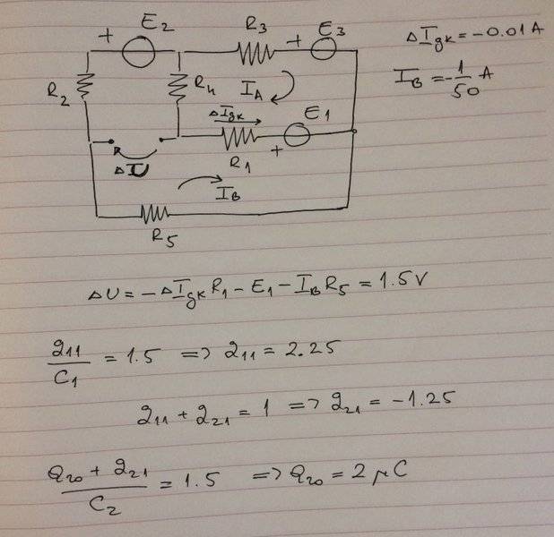

Now goind back to the original circuit, where i have the current through the branch when the switch closes i have enough information to find ##E_2## which later i can use to find the voltages across the capacitors. From mesh current analysis get that the loops that make ##ΔIg## are some ##IB and IA##
So by arbitrary choice:
##ΔI_g=I_b-I_a## and by means of mesh i get ##I_b## because i only need that one. I could go the other way but i need E2 then.
Here is the picture of the work:
Handwritten circuit schematic with resistors R1 to R5, voltage sources E1, E2, E3, a switch, and mesh currents IA and IB, followed by equations for delta U, q21, q20 and capacitor charge Q.
I get ##Q=2mC## while the answer is ##Q=-0.1mC##
Where and what is wrong?
I'm not sure why E2 is not given.
