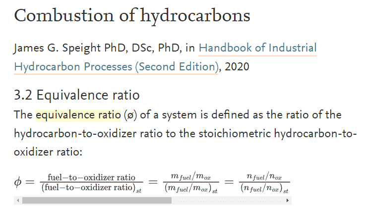

I'd like to do some experiments with flames at different Equivalence Ratios - but I'm confused as to how I can find the Equivalence Ratio for different conditions. Wiki-article
So the stoichiometric balance for Methane + Air is
CH4 + 2(O2 + 3.76N2) -> CO2 + 2H2O + 7.52N2
Referencing equations online, it looks like the Stoichiometric Fuel to Air ratio for Methane + Air is 1/2 (One mole of methane over two moles of air) - is this correct?

No. As you indicate, the ratio Methane/ oxygen is 1/2 (on a molecular base)
Don't post something like that without adding the links.
So I was mostly referencing this Section 3.2 book summary on Science Direct 1665250801791.png
So it would not be correct to say the Fuel to AIR ratio is 1/2. Instead the Fuel to Oxidizer (oxygen) is 1/2?
