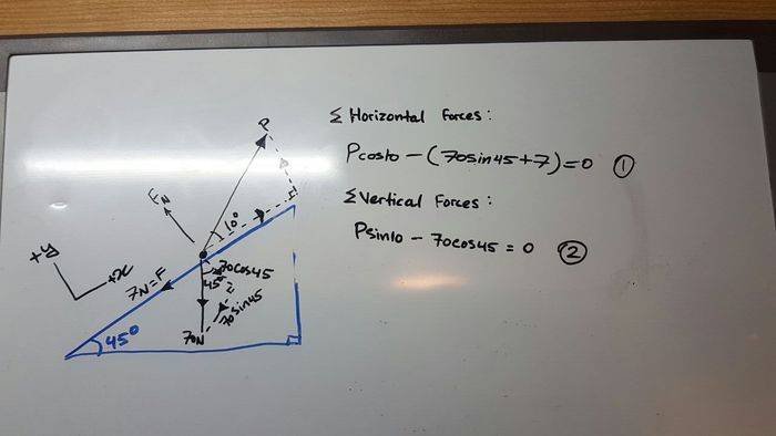

My value for P does not make any sense. Why is this so?
I think you may have forgotten one of the vertical forces.
Yeah, I'm almost certain that's the issue. I think it's the normal force, but what is the value of that force in this case?
Yes, you forgot the normal force when you summed the vertical forces. But I don't know what the value of that force is. You will just have to use a variable, FN, until you solve the equations and find its value.
Oh right, my bad. So for vertical forces my equation ends up being Psin10 - 70cos45 + Fn = 0. From the horizontal forces equation I calculated P to be 57.369...
Then, Fn = 39.535...
To sum it up, P = 57.4 and Fn = 39.54. These values satisfy both equations, though do you have any idea what reaction force they are referring to?
That looks right. I'm not sure but "reaction force", probably means the normal force.
Alright that's what I was thinking as well, no idea what else it could be. Thanks for the help.
