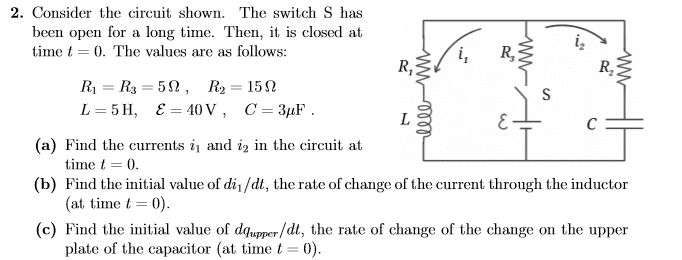

I used the loop rule where ##ΣΔV=0## and junction rule.
From here I get 4 equations
##i_3=i_1+i_2##
##ε-i_3R_3-i_1R_1-L(di\dt)=0##
##ε-i_3R_3-i_2R_2-Q\C=0##
##i_1R_1-L(di\dt)+Q\C+i_2R_2=0##
1-I said Q\C will disappear since Q=0 at t=0. But what about (di\dt) ? Is (di\dt)=0 ? I think it should be, but If its zero I didnt understand why it asked again since we need to claim its zero to solve the question.If its not zero then I couldn't solve the upper 4 equations.İts like something is missing.
You do not need any equations here.
Just apply what you know about the behaviour of L and C at the moment of energization i.e. t=0.
What is the current through the inductor "just before" the switch is closed?

Can you help a bit more..I couldn't see the solution
There was no source in the circuit before the switch is closed.
So what can you say about the inductor current "before" the switch is closed?
Zero ?
Arman777 said:
Zero ?
Yes. So what is the inductor current just after closing the switch?

What can you say about the current through the capacitor at t=0 i.e. just after the switch is closed?
Ok. I think you do need to solve the equations for solving b and c because of presence of R1. The current through R1 is governed by both L and C values. My apologies.
But you do not need them to know i1 and i2 at t=0.

The fourth equation is not needed. And di/dt should be di1/dt.
So you have the system of equations
##i_3=i_1+i_2##
##ε-i_3R_3-i_1R_1-L(di_1/dt)=0##
##ε-i_3R_3-i_2R_2-Q/C=0##
Substitute ##i_3=i_1+i_2## for i3. You might need the relation between Q and i2. Then you have a system of equations for two currents and their derivatives.
The problem asks the initial values. You found that i1(0)=0. What about i2(0)? Answer @cnh1995's question.

Zero ? At the beginning there should be no current ? Seems wrong but also makes sense.

I see well I find ##-i_2R_2=Q\C## but in any case at t=0,Q=0
Yes but for t>0 you should get something else

No, it is not true . You ignored i3, and it is not zero at t=0.

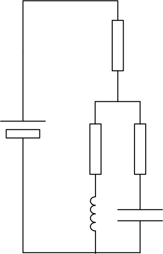

(e) No. draw the circuit a little differently: ##\varepsilon## on the left and all the R etc on the right
(f) What you say is true...

Substitute I3=I1+I2 into your second and third equations. What do you get?
Use that i1=0 and Q=0 at t=0 in the second equation. What is i2 at t=0?
Knowing i2(0) and i1(0) you get d(i1)/dt from the first equation.
I find ##i_2=2A## and ##di_1\dt=6A\s##
Correct, but use / in fractions, instead of \.
an oblique stroke (/) in print or writing, used between alternatives (e.g., and/or ), in fractions (e.g., 3/4 ), in ratios (e.g., miles/day ), or between separate elements of a text.
So ##di_1/dt=6A/s##.
Now take the derivative of the second equation, and use that i2=dQ/dt. Calculate di2/dt.

Well ##i_2=0## since capacitor is full.There can't be current.I couldn't find ##i_1##...I think its 1A but I am ot sure...I thought ##ε=i_1(R_1+R_3)+L(di_1/dt)##
Part (e) I guess Q=εC
Part (f) If its one ampere and I find charge correctly then ##U_L=1/2Li^2## and ##U_C=Q^2/2C##
