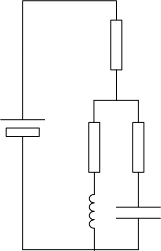

Arman777 said:
Well ##i_2=0## since capacitor is full.There can't be current.I couldn't find ##i_1##...I think its 1A but I am ot sure...I thought ##ε=i_1(R_1+R_3)+L(di_1/dt)##
After very long time, the circuit is in stationary state. Nothing changes, the time derivative of the currents. i 1=1 A and i2=0 are correct.
Arman777 said:
Part (e) I guess Q=εC
Part (f) If its one ampere and I find charge correctly then ##U_L=1/2Li^2## and ##U_C=Q^2/2C##
The capacitor is not connected directly to the battery, there are two resistors in between. Is some potential drop across those resistors?
Oh you are right yes, then ##Q/C=ε-i_3R_3-i_2R_2## ##i_2=0## and ##i_3=1A## ?
Yes.
