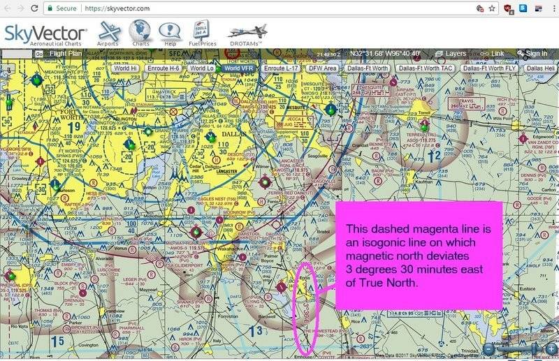

I've got at National Geographic map of Glacier National Park. It gives the magnetic deviation at the time of printing (2009) and the approximate change in deviation per year to keep it up to date.
Or, you can go to https://skyvector.com/ to look at up-to-date pilot's navigational charts, which show magnetic north deviations as isogonic lines. You have to zoom into find them. They're purplish in color and are labeled with degrees and minutes, like this screenshot showing a region southeast of Dallas, TX:

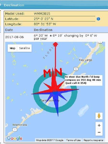

Something taught to every sailor is how to read both the declination of magnetic North and how to calculate its movement over the period since the map was published.
Every nautical map has a compass rose that shows both Mag North and its rate of change.
