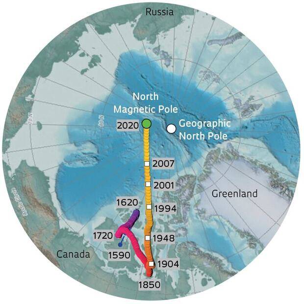

I was shocked to discover that over my lifetime (3 score and 11 yrs) the position of the magnetic north pole has changed enough to greatly diminish the incidence of big aurora borealis displays in the lovely state of Maine. C'est dommage
I suppose I should make the finer delineation that the "geomagnetic pole" (which is where your compass points) has shifted less than this. The "(not geo) magnetic pole" pictured above is where the field lines are vertical at the surface and thereby guide the solar ejecta. The last really ripping good Maine aurora I saw was on my birthday in1982...the whole damned sky was on fire

Look at it go! It isn't all that important though. First a little background. The magnetic field is generated by huge vortexes of liquid iron rising inside the Earth. It's like your bathtub drain vortex but rising instead of going downward. The liquid iron in the outer core is carrying heat away from the solid inner core as the Earth very slowly cools. We don't know much detail about these vortexes but we can observe three main concentrations of the magnetism they generate. These are underneath Canada, Siberia, and in between Australia and Antarctica. What we are seeing is the Canadian vortices growing weaker than the Siberian ones. Today they are roughly equal. I expect this trend to continue so that in thirty to seventy years the magnetic pole will be in Siberia.

Actually the solar ejecta are maximal where the field lines are maybe 85 degrees relative to Earth's surface. Auroras don't occur much at the magnetic poles. This is easily seen in photos of auroras from other planets.
The trapping of the ions is complicated and I never bothered to try to understand it.
