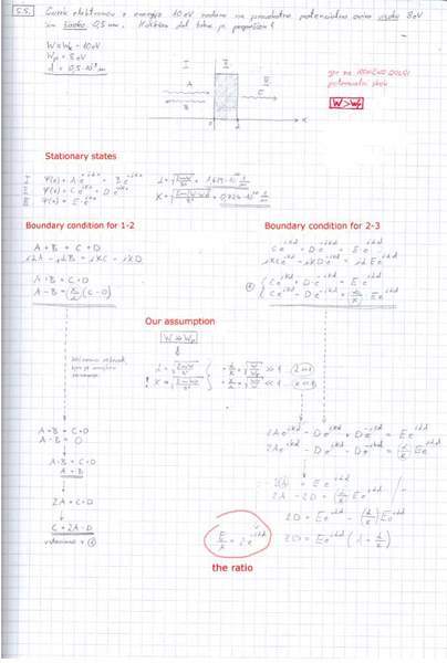

Beam of electrons with energy ##10eV## hits the potential step (##8eV## high and ##0.5nm## wide). How much of the current is transmitted?
I know that energy mentioned in the statement is kinetic energy so keep in mind when reading that ##E\equiv E_k##.
In our case the kinetic energy is larger than the potential energy ##\boxed{E>E_p}## and this is why stationary states for the regions 1, 2, 3 (picture) are as folows:

I first used the boundary conditions for the border 1-2 and got a system of equations:

Now i used the boundary conditions for the border 2-3 and got a system of equations in which i inserted the above result:

Now this result is what i don't understand. First equation gives me a ratio ##E/A=2\exp[-iLd]## which i think i need to calculate the transmissivity, but it is a complex exponential. Is this possible? How do i continue? Is this the way to solve this kind of case or did i go completely wrong?
This is my first finite potential well problem and i have been searching the web for a loong time to even find 2 videos (video 1 and video 2) for a similar problem but for the case when ##E<E_p##. The professor in the video allso uses similar approximation - but in his case ##E \ll E_p##.
In the appendix there is allso a scan of the problem solved on the paper just in case anyone likes it this way. It is in Slovenian language but i added some headings to help you reading.

You are on the right track. As you said, you need to calculate the transitivity, that will give you the desired probability.
##T=\left| \frac{E}{A} \right|^2##
You have some mistake on the result you've found anyway. I don't know where the mistake is, you should check it by your self, the transmission can never be bigger than one. You can find this problem solved in Cohen Tannoudji, if that helps. Page 72.

I don't think it's valid to consider 10 as being much greater than 8.

That link still looks kind of formidable to me. It's really not that hard to just push it through by elementary algebra. It helps to simplify the notation.
Let ##a = e^{iKd}##, ##b = e^{iLd}##, and ## r = \frac{K}{L}##. Then you can write your four boundary equations as
##A+B = C+D \ \ \ \ \ ## (1)
##A-B = rC - rD \ \ \ ## (2)
##aC+a^*D = bE \ \ \ \ \ ## (3)
##raC - ra^*D = bE \ \ \ ## (4)
Use (3) and (4) to solve for ##C## and ##D## in terms of ##E##.
Eliminate ##B## from (1) and (2) to get an equation that relates ##A## to ##C## and ##D##. Then substitute your expressions you found for ##C## and ##D## to get the relation between ##A## and ##E##.

After some algebra i did get the equation which gives the ratio between ##A## and ##E##:
$$\frac{A}{E}=\frac{e^{iLd}}{2LK}\left[ K^2 \cosh(iKd)-L^2\sinh(iKd)+KLe^{-iKd} \right]$$
I am a bit worried because i have a complex number in the hyperbolic cosine and sine. Is it still possible i am on the right track?
I know that for my case the transmission coeficient is calculated using this ratio i have obtained ##T=|E/A|^2## which means i will have to multiply the result by its complex conjugate, but will i get rid of those complex hyperbolic functions discussed earlier?

You can use the identities ##cosh(ix) = cos(x)## and ##sinh(ix) = isin(x)## to replace the hyperbolic functions with trig functions.
You appear to be on the right track. Most of your terms look like what you should get. However, your result is not yet correct. I believe that E/A should equal 1 in the limit d → 0.
Yes, you will get rid of the complex numbers when multiplying by the complex conjugate.
If you want to check some intermediate steps, I got the following expressions for C and D in terms of E
$$C = \frac{b(1+r)E}{2ar}$$ and $$D = -\frac{b(1-r)E}{2a^*r}$$
