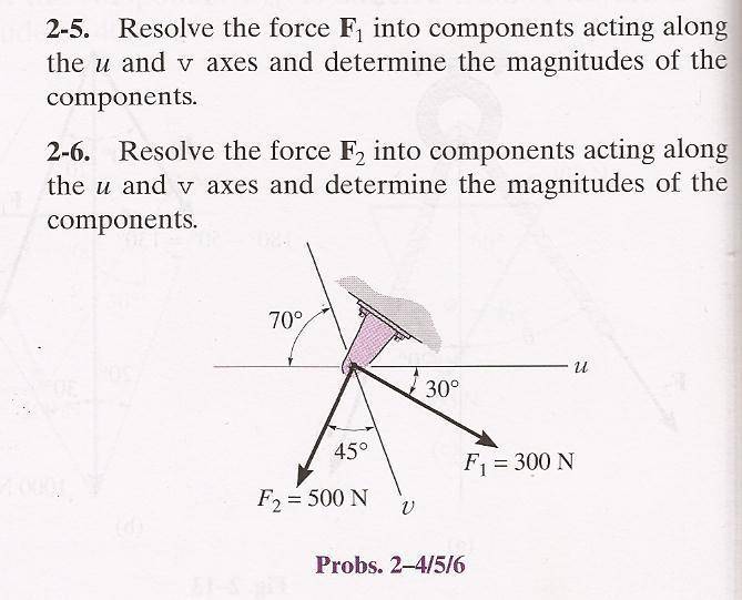

Resolve the force F1 into components acting along u and v axes and determine the magnitudes of the components. Refer to first attachment for full problem with diagram.
asinθ
bcosθ

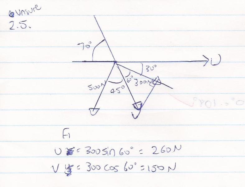

Please refer to attachments for attempt at solution, drawings of diagram involved. Could not get the correct answer solving the way in which I attempted, can anybody give me a hand solving it, answers in the book were:
f1u=205N, f2v=160N

The axes are not orthogonal.
The angle you have labeled as 60° is 40°. 30° + 40° = 70° .
(F1)v is a vector that's parallel to the v axis.
(F1)u is a vector that's parallel to the u axis.
(F1)v + (F1)u = F1
Superimpose an xy axis system onto the uv system, if that helps you.

Start with force vector F1. Your last drawing has the required angles labelled. What are the expressions for the u component of F1 and the v component of F1? Remember that u and v are not orthogonal (not at 90° to each other), so while the projection on one axis may be Fcos(θ), the projection on the other axis won't be Fsin(θ). Choose appropriate angles and use the cosine.
