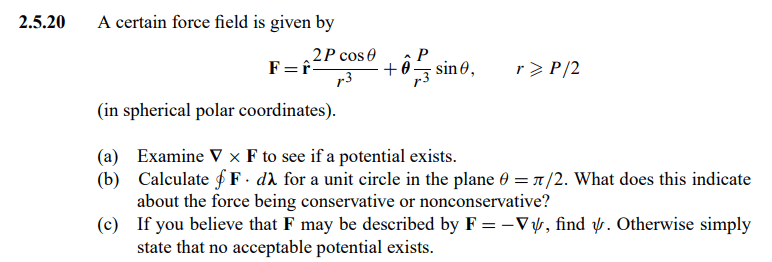

A certain force field is given to me and I should do the following tasks to find out is it a conservative field or not.
pls see below.
Picture of question:
Part (a) : ##\nabla \times \vec F = 0## so a Potensial exists. I don't have problem with this part.

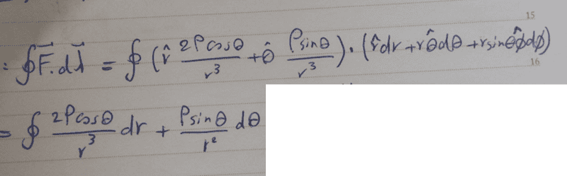

Part (b) : what I've done :
First experssion is 0 because ##\theta = \dfrac {\pi} {2}##. I don't know how to integrate over ##\theta ## when it is a constant.
Go back to where you wrote correctly $$d\vec{\lambda} = \hat r dr + r \hat \theta d \theta + r \sin \theta \hat \phi d \phi$$
Simplify this for integrating along the given unit circle.

Is it the only way? I haven't done this before and I cannot understand what you mean ...

Let's assume the unit circle is centered at the origin. For ##d\vec{\lambda}## along this circle, what can you say about the values of ##r##, ##dr##, ##d\theta## and ##\sin \theta##?
Thus, what does ##d\vec{\lambda}## simplify to?
I have checked my book again yet I could not find sth similar to this. I guess:
##r=1##
##\sin \theta=1##
##dr=dr##
##d \theta= 0##
If I'm right the second expression should be 0 to and I will get 0 as final answer.

OK, these look right. But you should be able to say more about ##dr##. Then you should be able to simplify the expression for ##d \vec \lambda## to a very simple result (which should make sense intuitively).
Then you can go on to think about the expression ##\vec F \cdot d\vec \lambda##

Sorry for taking your time ... Should ##dr## be 0 for the circle?
Can't I answer without ##dr##? The first expression was zero and ##dr## doesn't change anything.

Is this from a published source?? If so, please identify.
Yes.
This book is Arfken mathematical methods for physicists.
MatinSAR said:
Should dr be 0 for the circle?
You tell us. What is the definition of dr?
Radial spacing element If I have translated correctly.
Actually translating it to english is harder than its explanation for me.
So how does radius change along the circle if r=1?
It doesn't change since radius is constant for a circle.
Do you have access to Griffiths? Chapter 3.4.4. This field looks a lot like a dipole pointing in the z-direction. Just sayin’
That should answer part C.
Edit: A lot of dipole questions this week.
Yes. I will check. Thanks.
For part B can’t you use part A……via Stokes Theorem. Although I do think it is instructive to do the line integral directly.
And therefore dr is …
Good idea!
0 i think.
MatinSAR said:
0 i think.
Indeed.
You can also just use the parametrization ##\varphi = t## along with ##r=1## and ##\theta =\pi/2##. By definition
dr = \frac{dr}{dt} dt
and it should be pretty clear that ##dr/dt = 0##.
