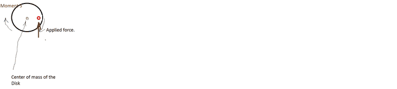

Is it convenient to ask (In Moment 5) approximately at what direction will appear the translational motion ?Ibix said:Assuming there aren't factors you aren't telling us about, yes.
See post #2...StoyanNikolov said:Is it convenient to ask (In Moment 5) approximately at what direction will appear the translational motion ?

Just to clarify the above situation and to ask if somebody can point at what direction will be the translational motion of the center of mass (center of the disk)?Ibix said:What didn't you understand about the answer in post #2, to which I have pointed you twice now?
Can you state Newton's Second Law?StoyanNikolov said:Just to clarify the above situation and to ask if somebody can point at what direction will be the translational motion of the center of mass (center of the disk)?

Please forget Moment 1.nasu said:It can translate, for sure. But this is because the net force is not zero at point 1, unless there is some non-disclosed interaction. You don't need this made-up definition of net force
I forget 1 then I don’t know what is the force vector, radius , direction and momentum for initial conditions undefined. It will tend towards stopping but even the slightest error will have residual motion.StoyanNikolov said:Please forget Moment 1.
Consider only moment 5.
Rotating object at constant angular velocity and
Applied force at the periphery, not the center of the disk
At what direction the center of mass will go?
Initial conditions are :TonyStewart said:I forget 1 then I don’t know what is the force vector, radius , direction and momentum for initial conditions undefined
What does your link say? I've already told you it has the answer. If you aren't sure you've got the correct answer from it, post what you've understood and we can go from there. If you aren't willing to go to the minimal effort of reading a link you supplied, I'm not willing to spend any more time helping.StoyanNikolov said:At what direction the center of mass of the disk
will go after the force is applied .
I don't find where it is written about the direction.Ibix said:What does your link say? I've already told you it has the answer. If you aren't sure you've got the correct answer from it, post what you've understood and we can go from there. If you aren't willing to go to the minimal effort of reading a link you supplied, I'm not willing to spend any more time helping.
How much mass do you need for a tangential force to accelerate rotation of a floating mass yet not accelerate center of mass to some motion as stated In a zero-g environment? Consider the solution to deflection massive asteroids from Earth collision! Even though an asteroid has considerable mass, the purpose of the mission is to deflect the path enough, normal, or perpendicular to the impulse or detonation applied. This has been proven to work.StoyanNikolov said:Initial conditions are :
Rotating disk at constant angular velocity.
StoyanNikolov said:Applied force is at the periphery of the disk (not the center)
will go after the force is applied . Thank you.
Just like on the attached picture.
Assuming other forces are either absent or negligible, it will move upwards.StoyanNikolov said:Please forget Moment 1.

- Is the center of mass initially at rest?StoyanNikolov said:Initial conditions are :
