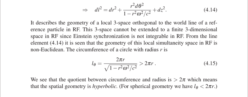

It is also very easy to show that the local spatial geometry of the disk is non-euclidean relative to the local rest spaces of observers atop the disk. It requires 3 to maybe 4 steps of algebra at best. However it's important to note that this is only the local geometry. Nothing can be said of the global geometry from this specific local geometry because the observers atop the disk cannot Einstein synchronize their clocks.
I would suggest you read the profuse of literature first before attempting to disprove well-established properties of the rigidly rotating disk.
You can measure the spatial geometry of the disc with rulers, without clocks and their synchronization issues. Rulers laid out on the rotating disc will measure a non-Euclidean ratio between radius and circumference.
That's local geometry not global geometry so it doesn't change a word of what I said. It's equivalent to saying that the constant curvature Riemannian quotient manifold obtained by identifying points on the same orbits of the Killing field ##\xi = \partial_t## in the rest frame of the rotating disk is hyperbolic. When we speak of metric geometry it is always local. Clearly this local geometry cannot be foliated into a global geometry because ##\xi## fails to satisfy the Frobenius condition for integrability i.e. ##\xi^{\flat}\wedge d\xi^{\flat} \neq 0## which is equivalent to the inability to extend local Einstein synchronization to a global synchronization relative to ##\xi##.
Read the attachment (taken from Gron's lecture notes on GR).
So if I measure the total diameter and total circumference of the disc, using rulers placed on it, then it is still a "local" measure, even if it encompasses the entire disc?
Yes because it depends only on the Riemannian metric in the local rest spaces of observers on the rotating disk; placing infinitesimal tangential rulers along the circumference of the disk and adding up their lengths and comparing the result to the added up lengths of infinitesimal radial rulers placed from the center to the circumference is equivalent to integrating the Riemannian metric of the quotient manifold along appropriate curves in order to obtain the relevant metrical measurements. In order to have any kind of global spatial geometry relative to ##\xi## for the disk obtained from the local rest spaces you would need to be able to define global simultaneity slices everywhere orthogonal to ##\xi## which is impossible because in the local rest spaces we have ##\vec{\nabla}\times \vec{\xi} \neq 0##. If you haven't already then read the attachment it will clear things up hopefully.

Exactly. And this is precisely why what we're measuring is the non-euclidean (local) metric geometry of the rotating disk relative to the instantaneous comoving inertial frames of points of the disk. In other words we're defining lengths of infinitesimal rulers using local Einstein (radar) simultaneity and using this to show that the curvature of the resulting metric is a constant negative value (hyperbolic). This is not the same thing as the global spatial geometry of the rotating disk obtained from a hypersurface orthogonal space-like foliation relative to the tangent field (in space-time) of the disk. Such a foliation is impossible to define for reasons already stated.

Did you read the attachment at all? I don't know how many more times to repeat it. There's a huge difference between local spatial geometry and global spatial geometry in relativity whenever we talk about extended bodies. Let the extended body be described by a time-like vector field ##\eta## in space-time and let ##\xi## be the tangent field to a family of observers. Then relative to ##\xi## we can define a spatial metric ##h_{\mu\nu} = g_{\mu\nu} + \xi_{\mu}\xi_{\nu}## where ##g_{\mu\nu}## is the space-time metric. This ##h_{\mu\nu}## describes the local spatial geometry of the disk relative to the observers following orbits of ##\xi##. On the other hand if we want to describe the global spatial geometry of the disk relative to ##\xi## then we need to be able to define a one-parameter family of global simultaneity slices ##\Sigma_t## orthogonal to ##\xi## everywhere. Each ##\Sigma_t## intersects ##\eta##, that is to say the entire world-tube of the disk, in some fashion and allows us to talk about the global spatial geometry of the disk i.e. the entire spatial shape of the disk relative to ##\xi##.
If ##\xi## represents the inertial observers at rest with respect to the axis observer then we can define such simultaneity slices in the usual way. On each such slice the disk just takes the form of...well...a flat disk. But if ##\xi## represents the observers at rest on the disk, meaning ##\xi = \eta##, then you clearly cannot define such simultaneity slices and the best you can do is probe the local spatial geometry of the disk using local rulers as defined by ##h_{\mu\nu}## i.e. you cannot define the entire spatial shape of the disk relative to these observers.

What is wrong with assuming that rulers laid out at rest on the disc tell us what the overall geometric spatial shape of the disk actually is?
Because it's a false assumption unless you want to play semantics and come up with a self-serving definition of "geometric spatial shape". This is basic differential geometry so I really don't want to keep repeating myself. The metric tensor is a characterization of the local geometry of a manifold. The overall (global) geometric spatial shape of an extended object relative to a family of observers doesn't even have meaning if you can't define "space at an instant of time" relative to this family. "Space at an instant of time" is purely conventional based upon simultaneity or synchronization. As already stated one cannot define "space at an instant of time" relative to the family of observers at rest on the disk if we want these "spaces" to be everywhere orthogonal to the tangent field of the family (propagation of local Einstein simultaneity throughout the family).
We can define "space at an instant of time" relative to this family as being the same as "space at an instant of time" relative to the inertial observers and we get back the flat circular shape for the disk as its overall spatial shape but this is clearly conventional and corresponds to synchronizing the standard clocks in the rest frame of the disk with the central clock i.e. we replace the standard clocks with the coordinate clocks in this rest frame following orbits of ##\nabla^{\mu}t##. This is distinct from the fact that the spatial metric relative to the family of observers atop the disk on the quotient manifold obtained by identifying points on single orbits of the tangent field to this family (the stationary Killing field) yields a hyperbolic geometry-this is derived entirely from local radar simultaneity and does not care about global simultaneity conventions.
I want a useful definition of "geometric spatial shape".
So defining "geometric spatial shape" based on "space at an instant of time" is not useful for a rotating disc.

Correct. There is space at an instant of time for a particular rim observer (if they don't push it too far). There is space at an instant of time for a central observer. But there is no collective instant of time that has any relevance to all disk observers.
The usual definition in relativity is the set of intersection points obtained by slicing the world-tube of the object by a space-like hypersurface.

The definition is completely general just like the definition of Einstein synchronization is completely general so it's not being defined on a case by case basis. However the main point is if we want the space-like hypersurfaces to be orthogonal to the world-tube of the disk then it's impossible to achieve this because the striations of the cylindrical world-tube are twisting around one another. In other words this is a special case wherein the general definition cannot be applied, just like the general definition of Einstein synchronization cannot be applied to certain special cases-that's all there is to it. So yes in that sense it is not useful simply because it cannot be applied. I hope that helps clear it up.
