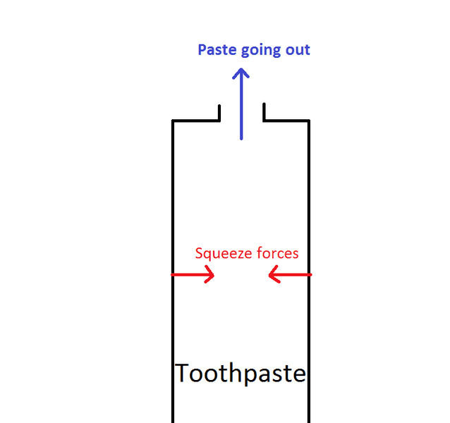

When I squeeze tube of toothpaste, I am working with 2 squeeze forces toward tube. Why it moves vertically from horizontally applied force (when I think of paste as a group of particles inside a tube I cannot imagine that) ?

I think that you're asking how a force applied in the direction of the red arrow can cause toothpaste to move in the direction of the blue arrow? Squeezing the tube increases the pressure in the tube, which pushes equally in all directions. The blob of toothpaste in the neck of the tube is subject to this pressure from one side but the other so moves down the neck and out of the tube.
The red arrows are just the forces you apply to the tube. The forces that the tube applies to the paste are distributed all over its inner surface. But there are none at the opening, so that's where the paste goes.

They aren't expanding. What makes a fluid a fluid (and different from a gas) is that no matter how hard you squeeze a fluid, its volume doesn't change.
Toothpaste is a fluid (a rather thick fluid, but still a fluid). So when I squeeze the sides of the tube and reduce the volume of the tube, the volume of the toothpaste stays the same. The only way that can happen is if some of the toothpaste leaves the tube because there's less room for it in the tube.
You could try putting your thumb over the mouth of the tube, holding it closed while you squeeze the tube from the sides. You will feel the toothpaste in the tube pushing against your thumb. That's pressure caused by your thumb holding the toothpaste in the neck in place; as long as that toothpaste can't move nothing can leave the tube so the volume of the tube can't change; . The harder you squeeze the tube, the greater the pressure - the only way the sides of the tube can move inwards reducing the volume of the tube is if some of the toothpaste in the tube forces your thumb aside so that it can escape.
