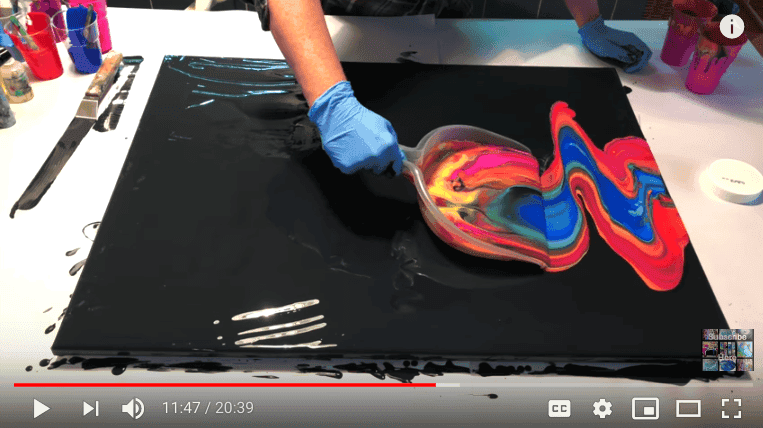

Re diffusion: diffusion constants are usually very small. From school, I vividly :wink: remember a demo with a measuring cylinder filled with water with a lump of CuSO4 thrown in. It would take many days for the blue to move upwards in the cylinder.
So yes, it's correct we can neglect... as you say.
But, as Chet writes and you suspect, diffusion does take place...
You can see a more intuitive demo in this screenshot of an artist's technique. Of course the paint colors mix due to diffusion, but the paint dries before the mixing becomes visible.
