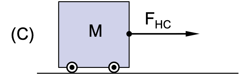

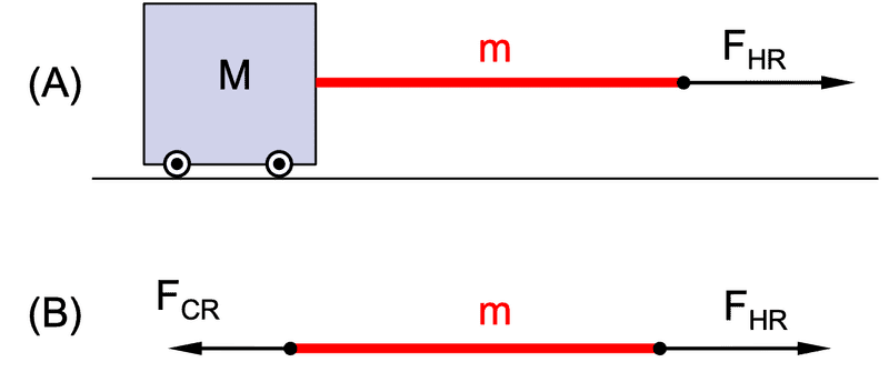

I think we agree but are talking past each other so let me do some math to explain what I am saying with equations instead of just words. Shown on the right are two FBDs: (A) for the massive rope plus cart and (B) for just the massive rope. Eventually, we will let the mass ##m## of the rope to go to zero. The double subscript label as in ##F_{\text{HR}}## indicates the force exerted by the Hand on the Rope.
From FBD (A) we get the common acceleration $$a=\frac{F_{\text{HR}}}{M+m}.$$From FBD (B), $$F_{\text{Net}}^{(\text{rope})}=F_{\text{HR}}+(-F_{\text{CR}})=\frac{mF_{\text{HR}}}{M+m}\implies F_{\text{CR}}=\frac{MF_{\text{HR}}}{M+m}.$$In the limit ##m=0## we get ##F_{\text{CR}}=F_{\text{HR}}##. I think that we both agree so far. At this point you have argued that when the rope is massless, ##F_{\text{HR}}## does positive work whilst ##F_{\text{CR}}## does an equal amount of negative work, therefore the net work don on the rope is zero, therefore there no change in the kinetic energy of the rope.
When I said (without equations),
kuruman said:
n terms of this example, the reaction to the action of the hand is exerted by the cart on the hand via the massless rope.
I meant that, in the case of a massless rope, it doesn't matter that ##F_{\text{CR}}=F_{\text{HR}}## and that the two forces do equal and opposite work on the rope. The change in a massless rope's kinetic energy is zero because, well, its mass is zero therefore its kinetic energy is always zero no matter what work is done on it.
Arguably, the length of the rope is irrelevant; it can be reduced to zero and the rope be ignored altogether without affecting the dynamics of the cart. A string with zero length and zero mass is no string at all.
It follows that the hand pulling a cart of mass ##M## through a massless rope can just as well be FBD (C) shown on the right. There is of course the reaction counterpart of the force exerted by the cart on the hand, ##F_{\text{CH}}##, which does not belong inside the FBD.
To summarize, when a massless, inextensible, string is attached to a system on one end and to a force ##F## on the other, one can always consider force ##F## applied directly on the system in the direction of the tension. That's what is implied when we say the "tension is the same at any point along the string."
All well argued and completely true.
None of this is in conflict with the fact that the mechanical work done by the hand on the end of the rope is given by the dot product of the force applied by the hand times the displacement of the rope end.
The inertial mass of the rope does not enter in. The extensibility of the rope does not enter in. The mass of whatever the rope is attached to does not enter in. If we know force and displacement, we simply compute their dot product.
We can all agree that in the case of a massless inextensible rope subject to no other forces that the work performed by the effort on the one rope end will be equal to the work performed by the other rope end on the load.
