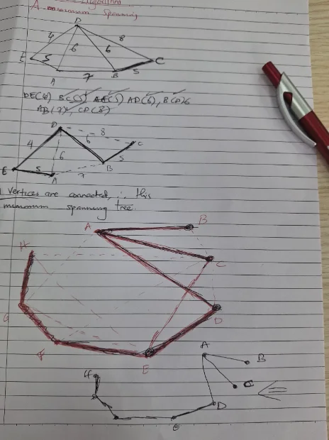

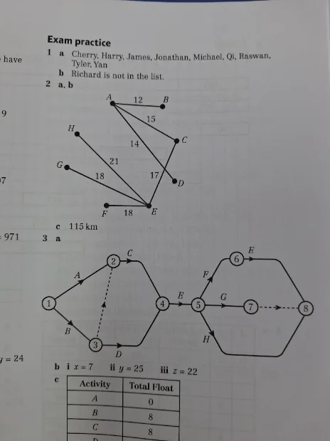

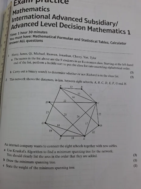

And this one, sorry, am using phone to type...
Number 2,
For kruskal algorithm, CE shouldn't be connected as it forms a cycle, correct? ...or a cycle refers to connected vertices? am I missing something. See my sketch...

chwala said:
Just counter check the phrase "twice as many pockets as desktop"
Is that correct? Is it not firstly, ##2y=x##
The phrase “there is twice as many ## y ## as ## x ##” means ## y=2x ##.
Yes, it does.
The edge CE is included into the minimum spanning tree too.
Gavran said:
Yes, it does.
I thought CE shouldn't be connected as shown on text, as that does not conform to the kruskal algorithm. I stand to be corrected.
Just seen that intersection can occur as long as the vertices are not connected to form loop, in that case the textbook is correct. Cheers man.
