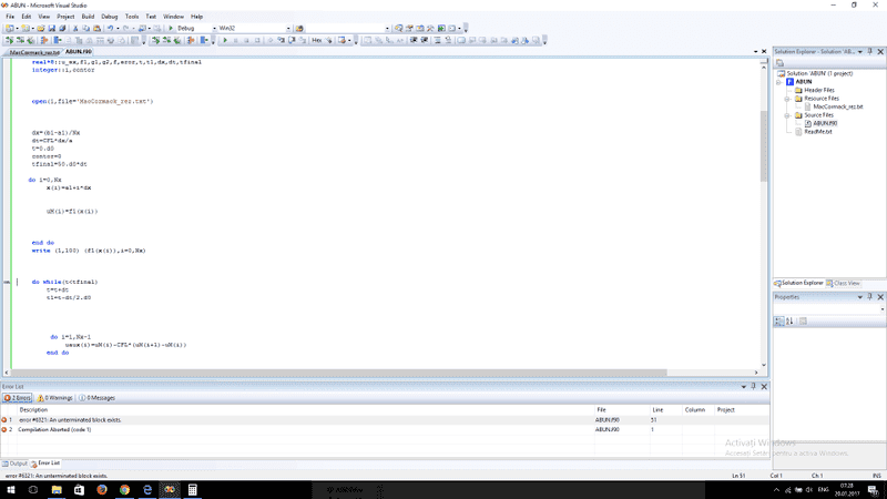

Hi i have a problem in solving the maccormack algorithm for the following :
∂p/∂t+8*∂p/∂x=0,x∈(-10,10)
p(x,t=0)=e**-3x
the exact solution is u exact(x,t)=e**-3(x-8t)
I have to verify the solution with the exact solution at t=50* dt
This is what I've done so far:

So what's wrong? A compiler error? A runtime error?

Your error, which was just barely legible in you screen shot, is "An unterminated block exists".
You're missing a program statement at the beginning of your main program. You have an end program statement, but not the program statement.
It should look something like this
Fortran:
program maccormack
    implicit none
    integer,parameter::Nx=100
    real*8,parameter::a1=-10.d0,b1=10.d0,CFL=0.01d0,a=8.d0
    real*8,dimension(0:Nx)::uM,uaux,unew,x
    real*8::u_ex,f1,g1,g2,f,eror,t,t1,dx,dt,tfinal
    integer::i,contor
    ! etc.
end program
function u_ex(x,t,a)
    implicit none
    real*8::u_ex,x,t,a
    real*8,parameter:: pi=4.d0*datan(1.d0)
    u_ex=dexp(-3.d0*(x-a*t))
end function
! Other function definitions
Also, this line:
Code:
      2.Mac Cormack
should either be removed or made into a comment. It is invalid Fortran code.
