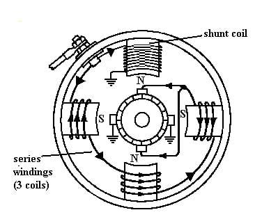

Carefully study your stator windings. This illustration copped from School Science Lessons shows one possible configuration for a starter motor with two (-) brushes and two (+) brushes that employs three series fields and a wound shunt field.

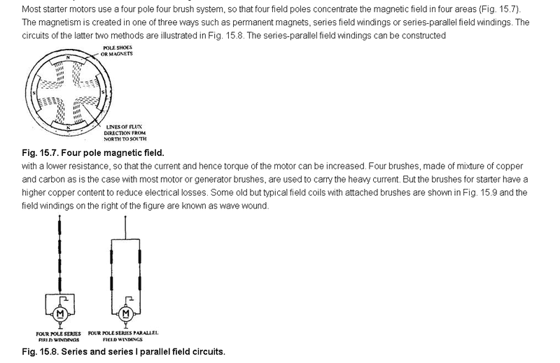

Starters for cars are made to deliver LOTS of torque, for obvious reasons. They usually are four brush so there's two paths for current so as to let plenty of it through. .
from a hobbyist page at http://what-when-how.com/automobile/starter-motors-and-circuits-automobile/

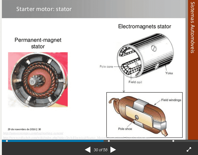

What's curious about your photo is the brushes aren't spaced 90 degrees apart, and that I've never encountered before.
Makes me wonder if you have a new variety of starter there with permanent magnet field , and brushes offset a little bit to counter distortion in the flux from large armature current? I don't know, just guessing.
Image from a pretty good slideshow tutorial at https://www.slideshare.net/MrioAlves18/08-starting-systems-for-road-vehicles
(his permanent magnet stator is six pole not four)
I ran across some descriptions of Japanese starters with both a permanent magnet AND windings in its field structure.. I'm thinking maybe that's what you have. Is it a reduction gear drive starter?

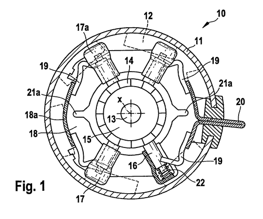

Aha ! Found a patent describing asymmetrical brush placement.
US 8395297
us
it is claimed to prolong brush life in machines that see unusual numbers of start cycles.

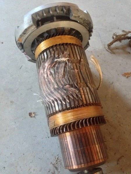

A powerful series wound DC motor with no load will run away until centrifugal force destroys it. The shunt field limits its RPM should the gear fail to engage flywheel.
I had a mid 60's Opel starter sling the conductors out of the rotor because of that.
electric car, guy floored it in neutral...

as to that ruined motor above when the guy floored it in neutral- I thought once the engine had started- the starter motor had no more role to play and isn't spinning- what does it matter how hard he revs in neutral?
It was an electric car and that's its 'engine'. Similar to a starter motor but bigger.
Apparently that electric car did not have a rev limiter. .
