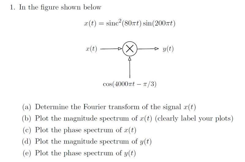

See figure attached.
See pdf attached for my attempt at the solution.
I'm a little confused as to how to draw the phase spectrum for y(t). Would it simply be a line equation of,
[tex]-\frac{\pi}{6000}f \pm \frac{\pi}{2}[/tex]
for each given triangle?(the +/- is selected accordingly of course)
Aside from that, are there any other mistakes?
Cheers!

Since no one else has responded:
how did you obtain the phase spectrum of x(t)? If I knew that maybe we could figure out how to get that of y(t).
What you wrote looks very good.
