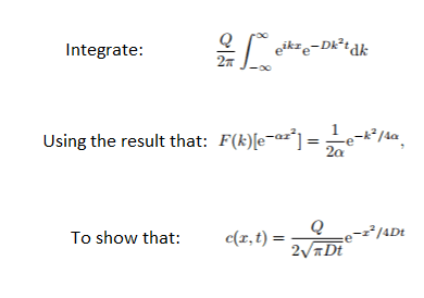

Problem
F denotes a forward Fourier transform, the variables I'm transforming between are x and k
- See attachment
Relevant equations
So first of all I note I am given a result for a forward Fourier transform and need to use it for the inverse one.
The result I am given to use, written out is :
## \int e^{-ikx} e^{-\alpha x^{2}} dx = \frac{1}{2\alpha} e^{-k^{2}/4\alpha} ##
I note that ## F(k) C(t) ## gives me a function of k, so I apply ## F^{-1} ## on this I get a function of x.
Attempt:
My thoughts are I'm looking to change signs in my exponential terms so that it is , effectively a forward transform and then use the result, so just thinking of it as a integration result rather than a particular Fourier transform.However if I do this my exponential terms are:## e^{-(-ikx+\alpha k^{2})} ##
, I don't know how I can then apply the result, completing the square looks like the only candidate to me , but this seems like it will be too scrappy, in particular with 'i' terms, how do I deal with this ## e^{ikx} ## term, if I'm on the right lines, is completion of the square necessary or is there some other approach to being able to use this result ?Many thanks in advance.
  • Three lines of math: Integrate: (Q/2π) ∫ from -∞ to ∞ of e^(ikx) e^(-Dk²t) dk; Using the result that: F(k)[e^(-αx²)] = (1/2α) e^(-k²/4α); To show that: c(x,t) = (Q/(2√(πDt))) e^(-x²/4Dt).
Not too scrappy, it will only give you an extra constant phase factor.
Anyway, you can just use the forward transform as a "template" with which you do the back transform. Note that in the RHS of the equation you are given, the expression is real so the sign of i should not matter.
No sorry I'm still totally stuck, I think I see the logic in your argument that the sign of i shouldn't matter but I don't see how I can apply the result given if the sign is wrong.
Any more hints anyone?
Cheers
How about making the change of variables ##k' = -k##?
From your given transform you should see at one something reminiscent of the quadratic formula for Re(a)>0
Which as you say relates to completing the square
$$\int_{-\infty}^\infty\! \exp\left(-a x^2+2b x+c\right) \,\mathrm{d}x=\\
\exp\left(\frac{b^2}{a}+c\right)\int_{-\infty}^\infty\! \exp\left(-a (x-b/a)^2\right) \,\mathrm{d}x=\\
\exp\left(\frac{b^2}{a}+c\right)\sqrt{\frac{\pi}{a}}$$
Notice the first integral cares what b is, but the second does not since the effect of b (and c) has been moved outside.
See that since b is squared in the result -(-i)^2= -i^2=1 and the sign does not matter

Even if you were to change the sign of ##i## or equivalently the sign of ##k## as suggested by vela above, you will get
$$\int e^{ikx} e^{-\alpha x^{2}} dx = \frac{1}{2\alpha} e^{-k^{2}/4\alpha}$$
If you are still wondering why this is true, try expanding ##e^{ikx}## into Cartesian form. The imaginary part of the integral that contains ##\sin kx## vanishes because the product with ##e^{-\alpha x^{2}}## results in an odd function and you integrate it over entire axis.

yeh that's all fine.
I don't know what result you've used in the last equality though, it wasn't using the result quoted in the OP which I'm trying to get at.
Anyway so completing the square I get:
##e^{(-1/D)\frac{x^{2}D^{2}}{4}} \int e^{-1/D(k-ixD/2)^{2}} dk ##
In order to then use the result given I need to write it in a similar complete square form in order to make a comparison...pretty sure this isn't what my lecturer was hinting at...

I don't know what Fourier convention is in use looks like a typo
I have
$$F(k)\left[e^{-\alpha x^2}\right]=
\int_{-\infty}^\infty\! \exp\left(-i k x-\alpha x^2\right) \,\mathrm{d}x=
\sqrt{\frac{\pi}{\alpha}}\exp\left(\frac{-k^2}{4\alpha}\right)$$
let 1/alpha=4D t
to see
$$\frac{1}{\sqrt{4D \pi t}}F(k)\left[e^{-\frac{ x^2}{4D t}}\right]=
\frac{1}{\sqrt{4D \pi t}}\int_{-\infty}^\infty\! \exp\left(-i k x-\frac{ x^2}{4D t}\right) \,\mathrm{d}x=
\exp\left(-D k^2t\right)$$
substitute it in
$$\frac{Q}{2\pi}\int_{-\infty}^\infty\! \exp\left(i k x-D k^2t\right) \,\mathrm{d}x=QF^{-1}(x)\left[e^{-D k^2t}\right]=QF^{-1}(x)\left[\frac{1}{\sqrt{4D \pi t}}F(k)\left[e^{-\frac{ x^2}{4D t}}\right]\right]$$
cancel the forward and inverse transforms to obtain the result

exactly what i was looking for,- thank you.
