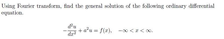

hey there.. i really don't know how to start answering this question.. can someone please guide me to solve this question..
Since the question tells you to use Fourier transforms, you start by taking the FT of both sides of the differential equation...

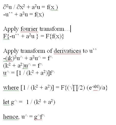

ok.. this is my full solution...
am i got it right until here?
That looks good, now use the composition rule to take the inverse FT of [tex]\hat{u}=\hat{g}\hat{f}[/itex]...[/tex]

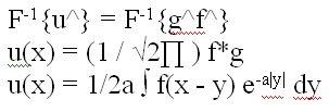

[tex] <br /> inverse both side...<br /> i get..<br /> <div class="bbImageWrapper js-lbImage" title="mathssss.jpg" data-src="https://www.physicsforums.com/attachments/mathssss-jpg.133258/" data-type="image" data-lb-sidebar-href="" data-lb-caption-extra-html="" data-single-image="1" > <img src="https://www.physicsforums.com/attachments/mathssss-jpg.133258/" data-url="" class="bbImage" data-zoom-target="1" style="" alt="mathssss.jpg" title="mathssss.jpg" width="472" height="79" loading="lazy" decoding="async" /> </div><br /> <br /> is that my general solution?[/tex]
Does [itex]\frac{1}{2a}\int f(x) e^{-a|x|}dx[/itex] really represent the convolution of [itex]f[/itex] and [itex]g[/itex]?
[tex] <br /> <blockquote data-attributes="" data-quote="gabbagabbahey" data-source="post: 2660196" class="bbCodeBlock bbCodeBlock--expandable bbCodeBlock--quote js-expandWatch"> <div class="bbCodeBlock-title"> gabbagabbahey said: </div> <div class="bbCodeBlock-content"> <div class="bbCodeBlock-expandContent js-expandContent "> Does [itex]\frac{1}{2a}\int f(x) e^{-a|x|}dx[/itex] really represent the convolution of [itex]f[/itex] and [itex]g[/itex]? </div> </div> </blockquote><br /> by convolution theorem,<br /> F^−1{F*G} = f ·g <br /> correct?<br /> so, i just substitute it..?<br /> kinda confused <img src="https://cdn.jsdelivr.net/joypixels/assets/8.0/png/unicode/64/1f615.png" class="smilie smilie--emoji" loading="lazy" width="64" height="64" alt=":confused:" title="Confused :confused:" data-smilie="5"data-shortname=":confused:" />[/tex]
ok.. i revised bout it already..
That's better!:smile:
However, that's just part of the general solution. You can also add any function, [itex]u_h[/itex], which satisfies the corresponding homogeneous ODE, [itex]-\frac{d^2 u_h}{dx^2}+a^2u_h=0[/itex], to the [itex]u(x)[/itex] you've found, and the result will still satisfy your ODE. So, you need to find that homogeneous solution and add it to what you've found above in order to obtain the true general solution.

the question ask me to find the general soltuion first..
then find when f(x) = x^5 & e^(x^2) exist or not,
if yes, i need to justify my answer..
