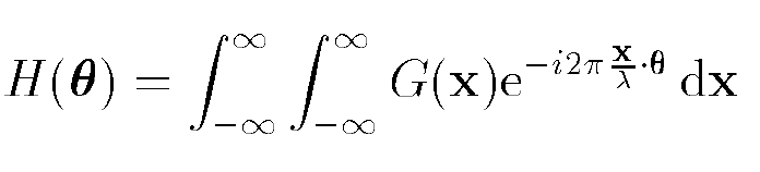

We know that the Fourier transformation in general is :

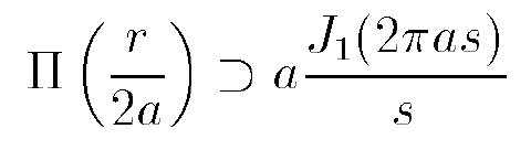

For circular aperture we have G(x)=Π(r/2a). So I thought that if I manage to turn the θ/λ inside the H(θ) equation into an s, (θ/λ=s or θ=λs), then I could say G(x)=Π(r/2a) ⊃ aJ1(2πas)/s, therefore H(θ)= aJ1(2πas)/s, but not this one exactly, because I need to change the s inside the H(θ) equation.
So H(θ=λs)=∫∫G(x)e-i2πsxdx

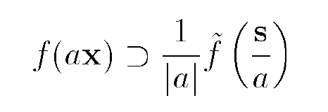

But now we have an H(λs) instead of an H(θ), so we need to use this Fourier property
and this is where I stop because I don't know which is which, and I don't know how this ⊃ works much.
I tried replacing the s with s=θ/λ and say
H(λ*θ/λ)=Η(θ)=aJ1(2πa(θ/λ))/(θ/λ) But I always get a result of

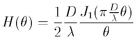

H(θ)=DλJ1(πDθ/λ)/(2θ) and the result is supposed to be this:
I always get the λ on the top. And again, when I tried using the
I still got the same result, although I'm not sure if I'm appliying this to the H(λs) right, but the book does say that I need to use the property above somewhere.

Start from [tex] H(\boldsymbol{\theta}) = \iint_{\mathbb{R}^2} G(\mathbf{x}) e^{-2\pi i \boldsymbol{\theta} \cdot \mathbf{x}}\,dA[/tex] where so far as I can tell from googling the aperture function [itex]G(\mathbf{x})[/itex] is equal to 1 if [itex]\|\mathbf{x}\| \leq a[/itex] and 0 otherwise. By symmetry we can orient the coordinate axes such that [itex]\boldsymbol{\theta} = (0,\theta)[/itex]. Now change to plane polar coordinates [itex](r, \phi)[/itex] to obtain [tex] H(\mathbf{\theta}) = \int_0^a r \int_{-\pi}^{\pi} e^{-2\pi i r \theta \sin \phi / \lambda}\,d\phi\,dr.[/tex] The integral over [itex]\phi[/itex] can be done by making use of the integral representation [tex]J_0(z) = \frac 1{2\pi} \int_{-\pi}^{\pi} e^{-iz\sin\phi}\,d\phi[/tex] and the resulting integral over [itex]r[/itex] can be done by substitution, noting that [tex] \frac{d}{dz} (zJ_1(z)) = zJ_0(z).[/tex]
