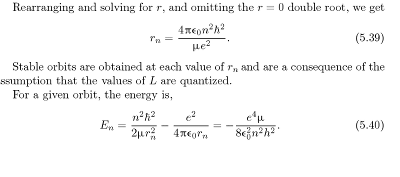

I was reading and came across a formula that didn’t look right so I tried to simplify the left side to match the right side; however, my fraction algebra is a little rusty and could use some guidance. I did get the 2 fractions to a common denominator; however, the best I could do was factor out an r. Here is the formula:
[tex] E_n=\frac{n^2h^2}{2\mu r_n^2}- \frac{e^2}{4\pi\epsilon_0 r_n}=-\frac{e^4\mu}{8\epsilon^2_0 n^2h^2}[/tex]

It looks like you're supposed to substitute rn from Eq. 5.39 into Eq. 5.40. However, I've tried it two different ways and I am not getting the RHS. I end up getting this:
[tex]\frac{n^2h^2}{2\mu r_n^2}- \frac{e^2}{4\pi\epsilon_0 r_n}=-\frac{e^4\mu}{32\pi^2\epsilon^2_0 n^2h^2}[/tex]

this looks correct. in the book you quoted, the formulae for En and rn are in terms of hbar, not h, which turns the 32π2hbar2 into 8h2.

Hey Deveno, I went back and looked at both formulas with my laptop and still didn’t see the hbar. Could be the resolution of the laptop is not so great. When first working this problems I wondered if those were Planck’s constants or Dirac’s constants. Subsequent to your note I posted some follow-up work on the formula and found it does not balance. Even though Dirac’s constant should have been used it still does not change the imbalance in the numeric constants. But, check it out if you want and let's see.

wait a minute...you factor 32 as 8*24 and 16 as 8*8?
Inverse the factored out variables and move to right side.
[tex] E_n=\frac{1 }{24 \pi^2 } -\frac {1}{8\pi^2} = -\frac {e^4\mu}{8\epsilon_0^2 n^2h^2}\frac {8 \epsilon_0^2 n^2h^2}{e^4\mu } [/tex]
you should have:
[tex]\frac{1}{4\pi^2} - \frac{1}{2\pi^2}[/tex]

no, it reduces to negative 1

what i get that you ought to have, is:
[tex]\frac{-1}{4\pi^2} = -\frac{\hbar^2}{h^2}[/tex]
which makes perfect sense.
What a silly mistake. All I can say is that it was late, I was in a rush and didn’t double check my work which I always try to do. Anyway, what you got does make sense and does balance out.
From you answer I see you used h and hbar. Thus, I am still working with a handicap because I cannot determine which terms are h and which terms are hbar in the original equation in the book. Deveno, would you kindly post the original formulas (5.40) and (5.39) so I can see which terms contain h and hbar. Please... Thanks
here is a magnified version of the equations in question (click on the thumbnail to see the larger version).

Deveno, THANKS!
Appreciate the help.
