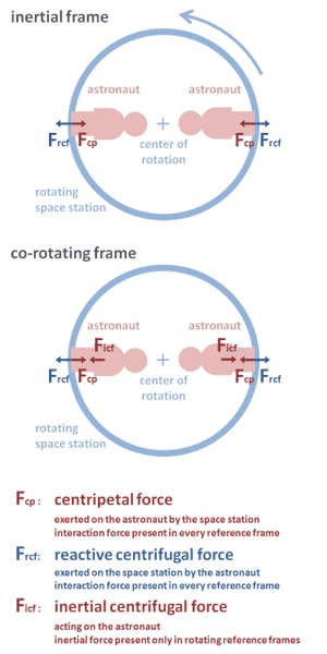

I allways think that centripetal force exist in every frame.
Isnt centirpetal force in plane own ref. frame gravity=mg?in this picture write it is present in every ref.frame ?
  • #100
It's wrong - where is it from?
Edit: Hi @A.T., I see this graphic is from an old post of yours.
In an observer's frame, the centripetal force is that component of the net force which accounts for an observed curved path. In the astronaut's own frame, the astronaut is stationary. No curved path to account for. Moreover, the centrifugal force exactly balances the normal force from the space station wall, so the net force is zero. This fits with the astronaut's view of being stationary.
Picture is wrong?so centripetal force don't exist in every frame?
You mean on observer at Earth ground?
What is definition of centripetal force:
1)every force which act towards center of rotation ?
2) net force of all forceses which act in radial direction?
3)net force of all forces which act towards center of rotation

The definition I use, and gave earlier, is that if the sum of the forces on the object is ##\vec F## and the velocity is ##\vec v## then the centripetal force is that component of ##\vec F## which is orthogonal to ##\vec v##.
The instantaneous centre of rotation can be deduced from the velocity and the centripetal acceleration, so I see no distinction between your options 2 and 3.
In a frame of reference in which the velocity has a constant direction the centripetal force must be zero. In particular, in the object's own frame there is necessarily no acceleration, so no centripetal force.
I think a lot of confusion arises because every student's introduction to centripetal force is in terms of objects constrained to circular paths by some tether. It conveys the notion that the radius is the given and the centripetal force is a consequence.

The centripetal force is [the horizontal component of] the force of the seat on your body. It is real. It is physical. It has a third law partner force: the force of your body on the seat. When we speak of a "centripetal force", we are not speaking about some special type of force. Instead, we are talking about the net force [from whatever source] that acts toward the center of a curved path. The centripetal force may, for example, be the force of road on tires, of seat on body, of centrifuge on test tube or of sling on stone.
The centrifugal force is the fictitious force associated with the adoption of a rotating frame. Its existence or not depends on the coordinate system that you have decided to use. It is fictitious. It has no third law partner force.
If you have adopted an inertial frame then the centrifugal force does not exist. Your body is accelerating around the corner in response to the only two forces there are: gravity and the force of the seat on your body. The net force is inward toward the center of your curved path. Your body accelerates. Newton's second law is upheld.
If you have adopted the rotating frame then the centrifugal force does exist. Your body is at rest and remains at rest throughout the exercise. There are three forces in play: gravity, the force of the seat on your body and centrifugal force. The net of these three forces acting on your body is zero. Your body remains at rest in its seat. Newton's second law is upheld.

jbriggs444 said:
No live creatures feel fictitious forces.
As I mentioned before, I think most people would say they 'feel' centrifugal force. Of course, what is felt directly is the normal force from the wall or side of the car, but since no acceleration is observed the brain infers a force pushing the body against the wall.
  • #120
Of course they feel centrifugal force.
In sharp left turn your head wonts to go the right,so your left muscle in neck must contract to keep head in stright position.
So from human perspective centrifugal force exist..
If you want imitate force on your head during left turn,you can put head strap which pull you to the right...
for same reason F1 drivers lean head into turn,so head gravity helps them fighting against centrifugal force..
