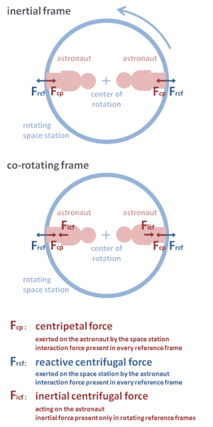

Can object feels coriolis force ,same as you can feel centifugal force when driving car in curve?
No. You cannot feel centrifugal force either. Nor can you feel gravity. Coriolis is the same.
What you can feel are the strains in your body as the car pushes you into the curve, or as the surface of the Earth pushes you upward against your otherwise downward trajectory.

  • #33
jbriggs444 said:
The effect of Coriolis on birds is entirely negligible. Just as it is on you when you walk down the aisle at the grocery store.
Instead birds ,use missile.
Accelometer in missle will not show acceleration caused by curved path to the right?
If I am in missile which travel to the north ,will I feel same force as when car going in right turn?

Again, you cannot feel any centrifugal force in a right turn. None. Nada. Zilch. Zip. Never. Ever.
What you can feel is the car forcing you to deviate from your natural free-fall trajectory. The car supports you against gravity and pushes you around the turn. The stresses from those forces are what you can feel.
An accelerometer in a cruise missile can sense the acceleration resulting when the missile's guidance system commands a slight left bank to compensate for the rightward deflection from Coriolis.
An accelerometer in a ballistic missile would feel nothing. The operator would have commanded a launch angle enough leftward so that Coriolis would result in a hit without any mid-course maneuvering.
