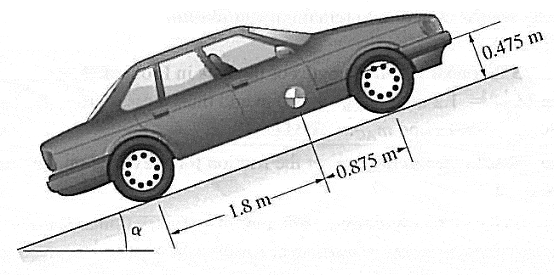

The car weighs 15kN. The coefficient of static friction between the car tires and the road is [tex]\mu[/tex]s=0.5. Determine the steepest grade (the largest value of the angle of [tex]\alpha[/tex]) the car can drive up at constant speed if the car has (a) rear-wheel drive, (b) front-wheel drive, and (c) four-wheel drive.
Free-body style diagram of a car on an incline, with angle alpha marked at the bottom left, a 1.8 m wheelbase dimension, 0.875 m from the center of gravity to the front wheel, and 0.475 m height of the center of gravity above the slope.
My answers are (a)10.18o (b)17.17o (c)26.57o. I just wonder if they are really correct. Thanks!

Let the normal forces at the rear wheel and the front wheel be NA and NB respectively. Also let the contact points at the rear and front wheel be A and B respectively.
(a)(1)0.5NA-15sin[tex]\alpha[/tex]=0 then NA=30sin[tex]\alpha[/tex] (2)0.875*15cos[tex]\alpha[/tex]+0.475*15sin[tex]\alpha[/tex]-2.675NA=0 then 13.125cos[tex]\alpha[/tex]+7.125sin[tex]\alpha[/tex]-2.675NA=0. Now from (1) and (2) tan[tex]\alpha[/tex]=7/39 then [tex]\alpha[/tex]=10.18o
Here I assume the rolling friction at the point B is ignorable. (1) is about the equilibrium of all forces in the horizontal direction. (2) is about the equations of moments around B.
Basically I did the same things for (b) and (c).
(b)tan[tex]\alpha[/tex]=72/233 then [tex]\alpha[/tex]=17.17o
(c)tan[tex]\alpha[/tex]=0.5 then [tex]\alpha[/tex]=26.57o

Sorry for not responding sooner.
I agree exactly with your method and answers, nice work! Intuitively, one would expect an all wheel drive vehicle to handle a grade steeper than front wheel or rear wheel drive only. But between front and rear wheel drive, you've got to crunch out the numbers to see which amongst the two can handle the steeper grade, because it depends on the location of the car's center of gravity. You've shown that quite nicely.
