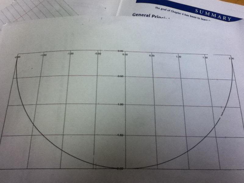

A block slides down a frictionless half-pipe (shown on the back of this page). It is released from rest at the point (2,0).
Determine the velocity, tangential acceleration, radial acceleration and angular acceleration when the block goes through angular displacements of 30, 60, 90, 120, 150 and 180 degrees respectively.
On the diagram, draw vectors to scale representing each of the linear quantities.
θ = s/r
Really all of the rotational motion equations. Including the rotational kinematics equations.
I calculated the displacement at each degree interval by converting the degress to radians and then using the equation θ = s/r.
My question to you is where do I go from here? The question doesn't give me anything else other than that it's dropped from rest.
Am I to assume that the radial acceleration is equal to gravity? Any help would be much appreciated.
Image of half-pipe attached.

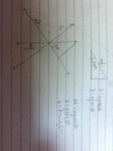

OK. How do I go about doing this? I attended my lecture today and discovered that you needed to draw out the free-body diagram for the object at a specific point. The normal points towards the middle of the circle, gravity downwards and the tangential acceleration is along the edge of the circle. I'm thinking that the equation you would use would be something like this:
ma = (mass)(gravity)sin(theta) --> Just like you would do for an inclined plane.
Cancel out the masses... solve for acceleration? However, I'm thinking that the above equation there is incorrect, because taking sin would give me the horizontal component of the acceleration, would it not? If that isn't the case, then I'm probably visualizing my FBD completely incorrectly.
All good. You need the force components tangent to the circle.
With the inclined plane you're given the angle with the horizontal, so the component of the weight parallel to the incline is mgsinθ. But here you need to find the angle that the tangent to the circle makes and relate that to the given angle θ. Draw yourself a careful diagram.

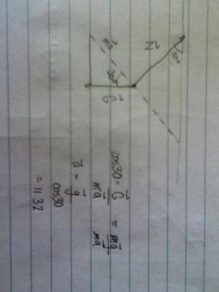

Like this? (See diagram)
The diagram looks OK, but your calculation does not. What you've labeled as G, is the weight of the object, mg, which acts down. What's the component of that force in the tangential direction? (You have the angle correctly shown.)
cos30ma? Because the hypotenuse of that triangle is equal to the force in the tangential direction?
AJDangles said:
cos30ma?
Nope.
You are finding one component of the weight. When finding the component of a vector, the full vector is the hypotenuse. That means mg is the hypotenuse, and the tangential component is one of the sides of the right triangle.
Doc Al said:
Nope.
Okay, now I'm really lost. It's been awhile since I've done this stuff.. does this have something to do with mg(parallel), that sort of thing (if I'm making any sense)?
I'm not sure I understand. You are trying to find the forces acting along the tangential direction. The only force with a tangential component is the weight mg. And the angle between the weight vector and the tangent direction is 30°.
How do you find components of a vector at a given angle?
Ok hold on; do I have everything in my diagram labelled correctly? Right now, I am confused as to why you say that mg is the hypotenuse when it's pointing straight down. To me, it looks as if the hypotenuse is the force/component which I have labelled as ma, and that mg would be one of the sides of the right-angle triangle.
Am I looking at the correct triangle here? Or are you talking about a right triangle which is completely different, and one that I haven't shown in my diagram?
Yes, the triangle you've drawn is incorrect. (But the direction of the force and tangent line are correct, which is what I was focusing on. Sorry about not pointing that out!) Since you are finding components of the weight, you must draw a new right triangle in which the weight is the hypotenuse.
Sanity check: A vector must always be bigger (or at least equal to) its components. So when drawing a right triangle to find components, the components must be the smaller sides, not the hypotenuse.
