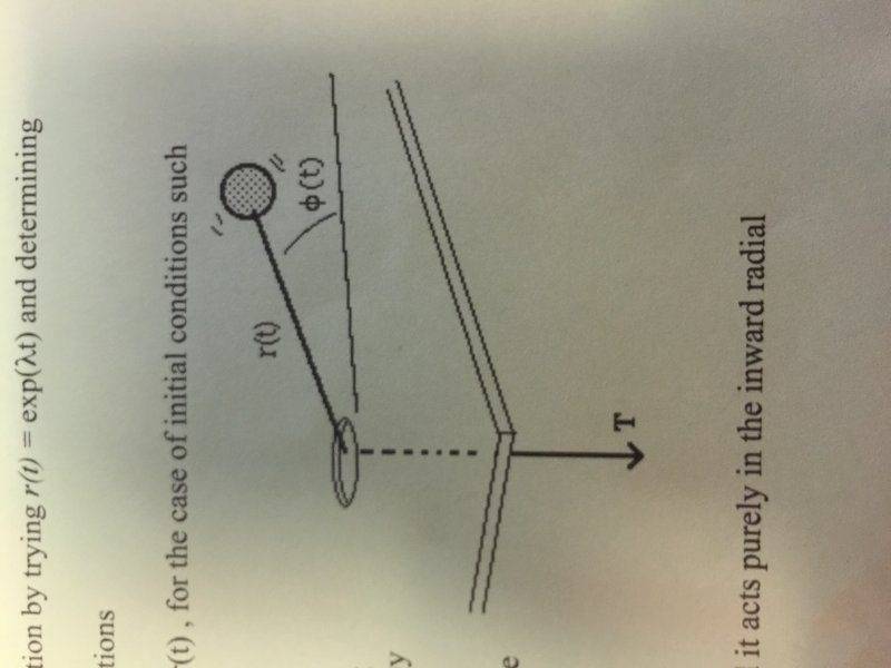

A particle of mass m slides (both sideways and radially) on a smooth frictionless horizontal table. It is attached to a cord that is being pulled downwards at a prescribed constant speed v by a force T (T may be varying)
Use F=ma in polar coordinates to derive an expression for the tension T (T will depend on r and θ and how they may be changing)
Show the particle's polar coordinates satisfy r2dθ/dt = constant
HINT: The only horizontal force on the particle is T and it acts purely in the inward radial direction. Also, dr/dt is known and it is equal to -v
a = (r''(t)w2)r_hat +(r(t)θ''(t) + 2r'(t)θ'(t))θ_hat
L(t) = L_o ?
Not entirely sure how to get started. I've identified that a_r must be zero (since dr/dt is a constant, r''(t) must be zero making a_r zero). I've also set up the equation a_θ = r(t)θ''(t) - 2vw since r'(t) = v and θ'(t) = w. The issue I'm having is trying to identify another equation for the acceleration (or force) in the θ direction, and then from there rectifying that into T.

That's part that's confusing... if there's only a force radially, θ''(t) should be zero. However, intuitively, as the radius gets shorter the particle should start rotating faster (cons. of ang. mom.) As far as aθ goes, I'm not exactly sure what the expression should be because I can't identify any forces working on the particle along that axis.
The other part that's messing with my head is the fact that, despite there being a force in the radial direction, there is no radial acceleration.
I've attached the image that came with the problem.

It turns out that ##a_\theta## is not equal to ##\small \ddot{\theta}##. Note: From your first post you wrote a = (r''(t)w2)r_hat +(r(t)θ''(t) + 2r'(t)θ'(t))θ_hat. So, you can read off ##a_\theta## from there.
Oh. That makes a lot of sense, thanks. How would I use that to get to T(t) though?

Consider ##a_r##. In your expression
it doesn't appear that you have written the r-component correctly.
(Note: there is a tool bar for formatting. Click on the ##\Sigma## tab for math symbols.
You know that ##r^2 \dot{\theta}## is a constant, say ##\small h##. So, ##r^2 \dot{\theta} = h##.Try to find an expression for ##a_r## in terms of just ## r## and ##h##. Then think about how ##r## changes with time.
