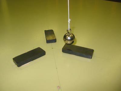

@LorenBoda, So you are looking for transitional chaos in damped systems. I think if you want to include general relativity you'll have to be more specific, but there is an example of a transitional chaos involving gravity.
It is an experiment with three magnets (positioned at the corners of a tiangle) and an iron ball that hangs above them exactly at the center.
When you release the ball its movement is linear (it's a damped pendulum). When the amplitude weakens it becomes chaotic (it can't decide which magnet attracts it more). When amplutide weakens even more, it settles and osscilates arround one of the magnets (yt the beggining you can't tell which one).
I actualy did the experiment once, here is a picture:
Cheers, Phantomas

Phantomas,
What would be the pattern of motion if the magnet system were superconducting?

Loren Booda said:
Phantomas,
The same.
This is a classical system, no matter whether the magnets are permanent magnet bars or superconducting electromagnets.
Why do you ask ? :confused:

Exactly.
It doesn't matter what kind of magnets you use.
If they are stronger you have to use a heavier ball to get the same results, or just hang it higher.
P.
