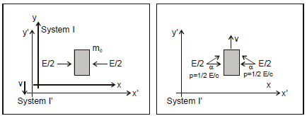

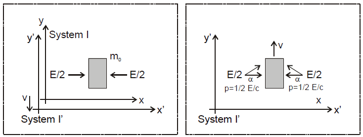

One of my books actually avoided this problem (I think) by considering two photons from opposite sides, cancelling out their momentum in the rest frame of the body:
However, I'm still wondering if you can derive ##E=m\cdot c^2## from ##\Delta E=\Delta m\cdot c^2## in a more "basic" way. An example: After my book derived time dilation by looking at a light clock and using Pythagoras, I asked myself why this can be generalized to all clocks, i.e. time itself. Then I came up with following thought experiment: Say we construct a clock with two minute hands directly above each other that conduct a current if and only if their tips both are at the 12 mark. If we now attach a device to that clock (say a bomb) and start both clocks at the same time, the minute hands both reach the 12 mark after the same time interval and the bomb explodes.
If we now watched this from a moving frame and time dilation only applied to the light clock, the hands wouldn't reach the 12 mark simultaneously and the bomb wouldn't explode from this frame. This is a logical absurdity and would lead to a whole lot of causality problems. Hence, time dilation applies to all clocks, or time itself.
Can we apply a similar, "simple and logical" thought experiment to show that ##\Delta E=\Delta m\cdot c^2## necessarily implies ##E=m\cdot c^2## and everything else leads to absurdities or causality problems? To be clear: I'm only talking about massive body at rest, for which ##E=m\cdot c^2## applies.

Sure, that was Einstein's original thought experiment: A body is emitting two photons back-to-back. I've no simpler way to explain it than Minkowski vectors. In fact it's the most simple way to derive relativistic formulae of all kind. For an introduction, see
http://th.physik.uni-frankfurt.de/~hees/pf-faq/srt.pdf
So here's the explanation of this case: Before the emission of the two photons we have one body at rest. It's four-momentum is given by
$$p_1=\begin{pmatrix}M c \\ 0 \\ 0 \\ 0 \end{pmatrix}.$$
After the emission you have a body with four-momentum ##p_1'## and two photons with four-momenta ##p_2'## and ##p_3'##. By assumption they are emitted back-to-back with the same magntitude of three-momentum, i.e., we have
$$p_2'=\begin{pmatrix} |\vec{p}_{\gamma}| \\ \vec{p}_{\gamma} \end{pmatrix}, \quad p_3'= |\vec{p}_{\gamma}| \\ -\vec{p}_{\gamma}.$$
From energy-momentum conservation you get
$$p_1'=p_1-p_2'-p_3'=\begin{pmatrix} Mc-2|\vec{p}_\gamma| \\0 \\0 \\0 \end{pmatrix}.$$
But the invariant mass ##M'## after the decay is given by
$$ p_1' \cdot p_1'=M'^2 c^2=(Mc-2 |\vec{p}_{\gamma}|)^2 \; \Rightarrow \; M'=M-2 |\vec{p}_{\gamma}|/c=M-2 E_{\gamma}/c^2.$$
So here the "naive" picture is exact.
So "##E=m c^2##" follows from the assumption that with defining energy and momentum of a particle such that these quantities form a four-vector in the sense explained in my previous section and the validity of energy-momentum conservation, which in fact is a consequence of the special-relativistic space-time symmetries (Noether's theorem).
