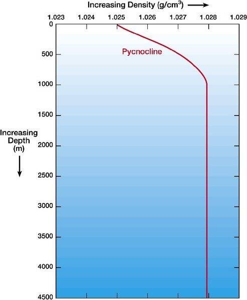

BTW, here is a chart of the compression of water as a function of depth.
http://www.windows2universe.org/earth/Water/density.html

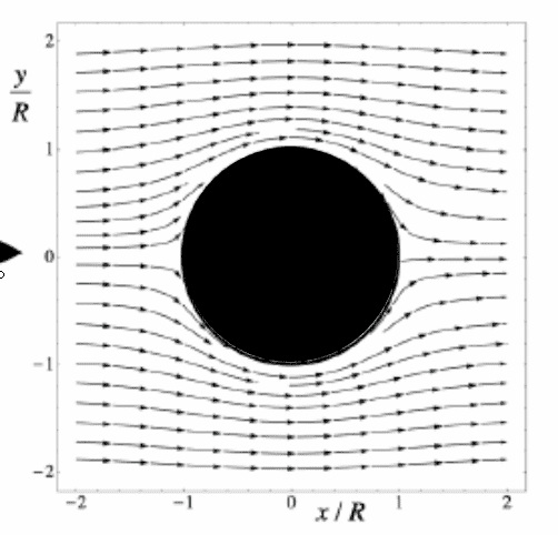

Let's forget about how the fish is being propelled for the moment. Let's just model the fish as a sphere that is moving forward in the tank at a constant velocity. Let's imagine that we are outside the tank and we are moving with the same velocity as the fish, so that the tank appears to us to be moving backwards. What does the streamline pattern in the tank look like to us (assuming the fluid is inviscid)?

Here is a diagram of the streamline pattern in inviscid incompressible fluid flow past a sphere, where the sphere is immersed in an infinite ocean of the fluid:
Only the region within one diameter on either side of the sphere is shown. But one will note that, even at such a short distance from the sphere, the streamlines at y = +2R and y = -2R are nearly horizontal. Further out, they become essentially indistinguishable from horizontal. So, if the side walls of the tank were at these further out locations, they would essentially coincide with the streamlines. So this picture presents an excellent representation of the streamline pattern in our tank as reckoned from the rest frame of reference of our fish (sphere). Notice how, close to the sphere, the streamlines get closer together. This also corresponds to higher down-channel flow velocities (in order for all the fluid to get past the sphere without having to be compressed). Notice also that it is not necessary to invoke a molecular approach to explain what is happening and that this flow occurs even if the fluid is perfectly incompressible.
This is the crux of the OP's question.
